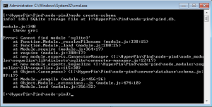

horseyhorsey Posted September 3, 2013 Posted September 3, 2013 Cannot find module sqlite3? Weed Me! HS App: HLM-Check Beta: PinXCheckTunes: http://soundcloud.com/vade/mistys-mind-horse-mix HyperSpin Multiplayer - Take Your Cab online
freezy Posted September 3, 2013 Author Posted September 3, 2013 Cannot find module sqlite3? Is this a rhetorical question? If not, I'd need more info than that, like * When does it happen * Where does it happen * What did you do to make it happen * Is there more displayed than this
horseyhorsey Posted September 3, 2013 Posted September 3, 2013 Just after the node create-schema cmd. Weed Me! HS App: HLM-Check Beta: PinXCheckTunes: http://soundcloud.com/vade/mistys-mind-horse-mix HyperSpin Multiplayer - Take Your Cab online
horseyhorsey Posted September 3, 2013 Posted September 3, 2013 Yes. I had allready done that before create-schema. I tried npm install again. I have the "node-pind\node_modules" directory open and can see it does create the sqlite3 folder but then deletes after it encounters some errors in the install. Weed Me! HS App: HLM-Check Beta: PinXCheckTunes: http://soundcloud.com/vade/mistys-mind-horse-mix HyperSpin Multiplayer - Take Your Cab online
freezy Posted September 3, 2013 Author Posted September 3, 2013 Did you install the build tools (Python / VC++ / SDK)? I've had similar issues compiling sqlite3 on Win8, you might need to google for a solution until they start releasing binary builds for the sqlite3 module.

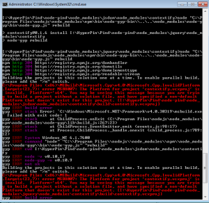

horseyhorsey Posted September 3, 2013 Posted September 3, 2013 So sqlite3 compilation went ok? What did you do? Well, I had to find pre compiled binary for the sqlite3 to eventually work. Then had to do a similar thing with jsdom, then with jquery and now completely stuck on contextify. This really is too much work & headache so far for Win7 64. Weed Me! HS App: HLM-Check Beta: PinXCheckTunes: http://soundcloud.com/vade/mistys-mind-horse-mix HyperSpin Multiplayer - Take Your Cab online

freezy Posted September 3, 2013 Author Posted September 3, 2013 Well, I had to find pre compiled binary for the sqlite3 to eventually work. Then had to do a similar thing with jsdom, then with jquery and now completely stuck on contextify. This really is too much work & headache so far for Win7 64. If you have more detailed instructions so others could benefit from it, that would be great. Apart from that, I know that on Windows it can quite a pain to get the node modules which need compilation working correctly. If it reassures you, I've spent quite some time on it too, but finally installing the SDK mentioned in the installation instructions did the trick.
MisterB Posted September 3, 2013 Posted September 3, 2013 From some quick reading, it looks like NPM is not expecting to provide a option for distributing Node module binaries any time soon. But in the case of this app, would it be possible to host and distribute precompiled binaries through the Git repository? Or is something like nexe a distribution option? Frankly, given the complexity and storage footprint of all of the prerequisites, it is probably going to scare many people away from this app. At the very least, it would probably result in a much higher level of support vs innovation.
