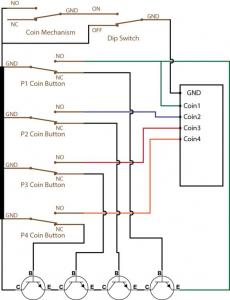

codemonkey76 Posted December 9, 2013 Author Posted December 9, 2013 I have been studying up on circuits and I have come up with this... (providing I am understanding correctly how transisters work) The bottom pathway that loops around to Coin1, can only be followed if none of the buttons are being held down.

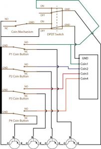

codemonkey76 Posted December 9, 2013 Author Posted December 9, 2013 woops. that bottom path can only be active when the coin mech is active, so needs to be passed through a double-pole switch.
