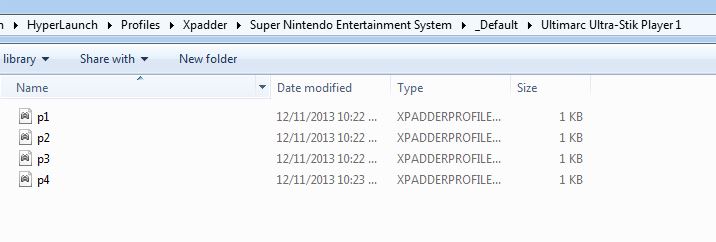

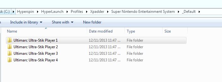

I have created seperate p1, p2, p3, p4, and blank xpadder profiles. I then put these profiles in the appropriate folder for Hyperspin, Hyperlaunch, _Default, etc. I go into HyperlaunchHQ and I go to each of the controls and hit the test button for the xpadder mapping. The mapping works but it just maps the keys to the player 1 joystick only regardless of which player I choose. For example, if I test p2 and I move the player 1 joystick, the keys I have assigned to the player 2 joystick display when I move the player 1 joystick.

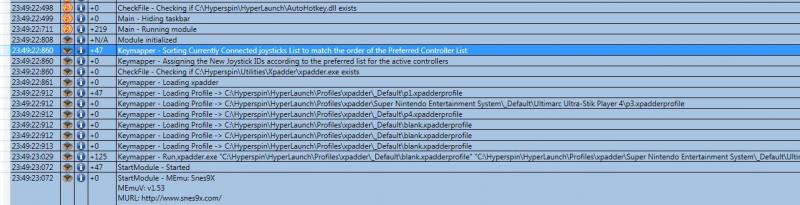

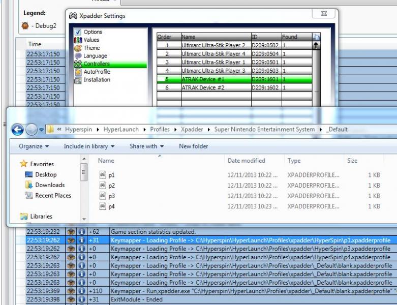

[ATTACH=CONFIG]36066[/ATTACH][ATTACH=CONFIG]36067[/ATTACH]

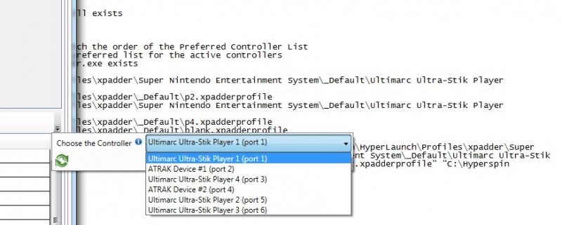

try using preferred controllers it should fix the controller ordering issue https://sites.google.com/site/hyperlaunch2/home/features/keymapper#TOC-Preferred-Controllers
I read your other post and did exactly that unfortunately it didn't solve my problem but its interesting to see what it actually did.

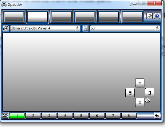

So I made p1, p2, p3, p4 in each of the controller names see the two pictures below for the structure.
I setup my controllers in the preferred order under the global tab and ensured in the super nintendo tab it was set the exact same

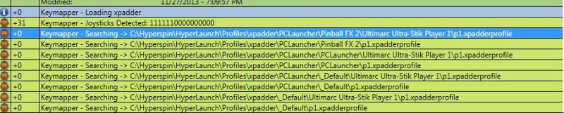

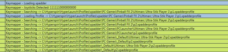

The resulting log which shows p2 not even being mapped.
Xpadder resulting profile: controller 3 blank, controller 4 p3 normal mapping, controller 1 blank, controller 2 blank.
Expected result all controllers blank.

00:24:44:062 | HL |     INFO  | +0     | BuildScript - Loaded Statistics.ahk script
00:24:44:062 | HL |     INFO  | +0     | BuildScript - Loaded User Functions.ahk script
00:24:44:062 | HL |     INFO  | +0     | BuildScript - Finished injecting functions into module
00:24:44:062 | HL |     INFO  | +0     | Main - Module is built
00:24:44:062 | HL |     INFO  | +0     | CheckFile - Checking if C:\Hyperspin\HyperLaunch\AutoHotkey.dll exists
00:24:44:063 | HL |     INFO  | +0     | Main - Hiding taskbar
00:24:44:282 | HL |     INFO  | +219   | Main - Running module
00:24:44:377 | MD |     INFO  | +N/A   | Module initialized
00:24:44:423 | MD |     INFO  | +47    | Keymapper - Sorting Currently Connected joysticks List to match the order of the Preferred Controller List
00:24:44:423 | MD |     INFO  | +0     | Keymapper - Assigning the New Joystick IDs according to the preferred list for the active controllers
00:24:44:423 | MD |     INFO  | +0     | CheckFile - Checking if C:\Hyperspin\Utilities\Xpadder\xpadder.exe exists
00:24:44:423 | MD |     INFO  | +0     | Keymapper - Loading xpadder
00:24:44:478 | MD |     INFO  | +47    | Keymapper - Loading Profile -> C:\Hyperspin\HyperLaunch\Profiles\xpadder\_Default\p1.xpadderprofile
00:24:44:478 | MD |     INFO  | +0     | Keymapper - Loading Profile -> C:\Hyperspin\HyperLaunch\Profiles\xpadder\Super Nintendo Entertainment System\_Default\Ultimarc Ultra-Stik Player 4\p3.xpadderprofile
00:24:44:479 | MD |     INFO  | +0     | Keymapper - Loading Profile -> C:\Hyperspin\HyperLaunch\Profiles\xpadder\_Default\p4.xpadderprofile
00:24:44:479 | MD |     INFO  | +0     | Keymapper - Loading Profile -> C:\Hyperspin\HyperLaunch\Profiles\xpadder\_Default\blank.xpadderprofile
00:24:44:584 | MD |     INFO  | +109   | Keymapper - Run,xpadder.exe "C:\Hyperspin\HyperLaunch\Profiles\xpadder\_Default\blank.xpadderprofile" "C:\Hyperspin\HyperLaunch\Profiles\xpadder\Super Nintendo Entertainment System\_Default\Ultimarc Ultra-Stik Player 4\p3.xpadderprofile" "C:\Hyperspin\HyperLaunch\Profiles\xpadder\_Default\blank.xpadderprofile" "C:\Hyperspin\HyperLaunch\Profiles\xpadder\_Default\blank.xpadderprofile" "C:\Hyperspin\HyperLaunch\Profiles\xpadder\_Default\p1.xpadderprofile" "C:\Hyperspin\HyperLaunch\Profiles\xpadder\_Default\p4.xpadderprofile" /M, C:\Hyperspin\Utilities\Xpadder, Hide
00:24:44:621 | MD |     INFO  | +47    | StartModule - Started
00:24:44:621 | MD |     INFO  | +0     | StartModule - MEmu: Snes9X
				MEmuV: v1.53
				MURL: http://www.snes9x.com/
				MAuthor: djvj
				MVersion: 2.0
				MCRC: 35A80127
				iCRC: FD5A1CE
				MID:
				MSystem: "Nintendo Super Famicom","Super Nintendo Entertainment System"
00:24:44:621 | MD |     INFO  | +0     | StartModule - You have a supported System Name for this module: "Super Nintendo Entertainment System"
00:24:44:621 | MD |     INFO  | +0     | StartModule - Ended
00:24:44:621 | MD |     INFO  | +0     | StartGlobalUserFeatures - Starting
00:24:44:621 | MD |     INFO  | +0     | StartGlobalUserFeatures - Ending
00:24:44:621 | MD |     INFO  | +0     | Module Setting - Fullscreen: true
00:24:44:621 | MD |     INFO  | +0     | Module Setting - EmulateFullscreen: true
00:24:44:621 | MD |     INFO  | +0     | Module Setting - WindowMaximized: true
00:24:44:621 | MD |     INFO  | +0     | Module Setting - Stretch: true
00:24:44:621 | MD |     INFO  | +0     | Module Setting - MaintainAspectRatio: true
00:24:44:621 | MD |     INFO  | +0     | Module Setting - HideMenu: true
00:24:44:621 | MD |     INFO  | +0     | Module Setting - FullScreenWidth: 1920
00:24:44:621 | MD |     INFO  | +0     | Module Setting - FullScreenHeight: 1080
00:24:44:621 | MD |     INFO  | +0     | CheckFile - Checking if C:\Hyperspin\Emulators\Snes9x\snes9x-1.53-win32-x64\snes9x.conf exists
00:24:44:624 | MD |     INFO  | +0     | Module Run - Running: C:\Hyperspin\Emulators\Snes9x\snes9x-1.53-win32-x64\snes9x-x64.exe "D:\HyperSpin ROMS\SNES roms\ABC Monday Night Football (USA).zip"
00:24:44:639 | MD |     INFO  | +15    | Module WinWait - Waiting for Snes9X ahk_class Snes9X: WndClass
00:24:44:777 | MD |     INFO  | +141   | Module WinWaitActive - Waiting for "Snes9X ahk_class Snes9X: WndClass"
00:24:44:886 | MD |     INFO  | +109   | Module Process - WaitClose snes9x-x64.exe
00:24:48:450 | MD |     INFO  | +3557  | Module WinClose - Closing: Snes9X ahk_class Snes9X: WndClass
00:24:48:678 | MD |     INFO  | +234   | StopGlobalUserFeatures - Starting
00:24:48:678 | MD |     INFO  | +0     | StopGlobalUserFeatures - Ending
00:24:48:678 | MD |     INFO  | +0     | ExitModule - Started
00:24:48:678 | MD |     INFO  | +0     | Starting Updating Statistics:
00:24:48:679 | MD |     INFO  | +0     | CreateRomTable - Started
00:24:48:679 | MD |     INFO  | +0     | CreateRomTable - Ended, 7 Loops to create table.
00:24:48:751 | MD |     INFO  | +62    | Game section statistics updated.
00:24:48:780 | MD |     INFO  | +32    | Keymapper - Loading Profile -> C:\Hyperspin\HyperLaunch\Profiles\xpadder\_Default\blank.xpadderprofile
00:24:48:780 | MD |     INFO  | +0     | Keymapper - Loading Profile -> C:\Hyperspin\HyperLaunch\Profiles\xpadder\HyperSpin\Ultimarc Ultra-Stik Player 4\p3.xpadderprofile
00:24:48:780 | MD |     INFO  | +0     | Keymapper - Loading Profile -> C:\Hyperspin\HyperLaunch\Profiles\xpadder\_Default\blank.xpadderprofile
00:24:48:781 | MD |     INFO  | +0     | Keymapper - Loading Profile -> C:\Hyperspin\HyperLaunch\Profiles\xpadder\_Default\blank.xpadderprofile
00:24:48:885 | MD |     INFO  | +109   | Keymapper - Run,xpadder.exe "C:\Hyperspin\HyperLaunch\Profiles\xpadder\_Default\blank.xpadderprofile" "C:\Hyperspin\HyperLaunch\Profiles\xpadder\HyperSpin\Ultimarc Ultra-Stik Player 4\p3.xpadderprofile" "C:\Hyperspin\HyperLaunch\Profiles\xpadder\_Default\blank.xpadderprofile" "C:\Hyperspin\HyperLaunch\Profiles\xpadder\_Default\blank.xpadderprofile" "C:\Hyperspin\HyperLaunch\Profiles\xpadder\_Default\blank.xpadderprofile" "C:\Hyperspin\HyperLaunch\Profiles\xpadder\_Default\blank.xpadderprofile" /M, C:\Hyperspin\Utilities\Xpadder, Hide
00:24:48:901 | MD |     INFO  | +15    | ExitModule - Ended
00:24:48:902 | MD |     INFO  | +0     | End of Module Logs
00:24:48:942 | HL |     INFO  | +4664  | Main - Module ended, exiting HyperLaunch normally
00:24:48:942 | HL |     INFO  | +0     | ExitScript - Started
00:24:49:169 | HL |     INFO  | +219   | SystemCursor - Restoring mouse cursor
00:24:49:181 | HL |     INFO  | +15    | ExitScript - Ended
Another update. The problem is the preferred order is not working correctly. It is just taking whatever order windows gives it. I can only select through windows which device it selects first by going to start -> devices and printers-> Right click a controller and go to game controller settings -> Advanced -> Select Ultra stick 1 as the preferred gaming device.
So Hyperlaunch looks in the following order:
So now after I changed the preferred control through windows to the ultra stick 1, it loads the p1 profile from the Ultimarc Ultra-Stik Player 1 correctly.
Hyperlaunch then looks at my first AIMtrack and tries to find a controller profile in the Super nintendo folder, it can't so it assigns it a default profile p2
Hyperlaunch then sees Ultrastick 4 (as per the windows ordering) and assigns it profile p3 in Ultimarc Ultra-Stik Player 4 folder
Hyperlaunch then sees the second aim track and tries to find a controller profile in the Super nintendo folder, it can't so it assigns it a default profile p4
Hyperlaunch now see the Ultrastick 2 and assigns it a blank profile as all the p ones were used
Hyperlaunch now see the Ultrastick 3 and assigns it a blank profile as all the p ones were used
So now I have to figure out either how to change the windows order or how to get preferred controllers to work correctly.
Please find attached my log

00:24:44:061 | HL |     INFO  | +0     | BuildScript - Loaded XHotkey Init.ahk scripts
00:24:44:061 | HL |     INFO  | +0     | BuildScript - Loaded Keymapper Init.ahk scripts
00:24:44:062 | HL |     INFO  | +0     | BuildScript - Loaded Statistics Init.ahk scripts
00:24:44:062 | HL |     INFO  | +0     | BuildScript - Loaded User Functions Init.ahk script
00:24:44:062 | HL |     INFO  | +0     | BuildScript - Module:
				MEmu = Snes9X
				MEmuV =  v1.53
				MURL = http://www.snes9x.com/
				MAuthor = djvj
				MVersion = 2.0
				MCRC = 35A80127
				iCRC = FD5A1CE
				MID = 635038268923820476
				MSystem = "Nintendo Super Famicom","Super Nintendo Entertainment System"
				; Notes:
				; Fullscreen is controlled via the variable below
				; snes9x adjusts the windowed resolutions in the ini automatically based on the settings you choose below.
				StartModule()
				FadeInStart()
				EmulateFullscreen := IniReadCheck(settingsFile, "Settings", "EmulateFullscreen","true",,1)		; This helps fading look better and work better on exit. You cannot use this with a normal fullscreen so one has to be false
				WindowMaximized := IniReadCheck(settingsFile, "Settings", "WindowMaximized","true",,1)
				Stretch := IniReadCheck(settingsFile, "Settings", "Stretch","true",,1)
				MaintainAspectRatio := IniReadCheck(settingsFile, "Settings", "MaintainAspectRatio","true",,1)
				HideMenu := IniReadCheck(settingsFile, "Settings", "HideMenu","true",,1)
				FullScreenWidth := IniReadCheck(settingsFile, "Settings", "FullScreenWidth","1920",,1)
				FullScreenHeight := IniReadCheck(settingsFile, "Settings", "FullScreenHeight","1080",,1)
				snes9xConf := CheckFile(emuPath . "\snes9x.conf")
				; Now let's update all our keys if they differ in the ini
				iniLookup =
				( ltrim c
				   Display\Win, Fullscreen:Enabled, %Fullscreen%
				   Display\Win, Fullscreen:EmulateFullscreen, %EmulateFullscreen%
				   Display\Win, Window:Maximized, %WindowMaximized%
				   Display\Win, Stretch:Enabled, %Stretch%
				   Display\Win, Stretch:MaintainAspectRatio, %MaintainAspectRatio%
				   Display\Win, Fullscreen:Width, %FullScreenWidth%
				   Display\Win, Fullscreen:Height, %FullScreenHeight%
				   Display\Win, HideMenu, %HideMenu%
				Loop, Parse, iniLookup, `n
				{	StringSplit, split, A_LoopField, `,, %A_Space%%A_Tab%
					IniRead, tempVar, %snes9xConf%, %split1%, %split2%
					If ( tempVar != split3 )
						IniWrite, % split3, %snes9xConf%, %split1%, %split2%
				Run(executable . " """ . romPath . "\" . romName . romExtension . """", emuPath)
				WinWait("Snes9X ahk_class Snes9X: WndClass")
				WinWaitActive("Snes9X ahk_class Snes9X: WndClass")
				FadeInExit()
				7zCleanUp()
				FadeOutExit()
				ExitModule()
				CloseProcess:
					FadeOutStart()
					WinClose("Snes9X ahk_class Snes9X: WndClass")
				Return
				MEmuV: v1.53
				MAuthor: djvj
				MVersion: 2.0
				MCRC: 35A80127
				iCRC: FD5A1CE
				MID:

14:58:11:091 | HL |     INFO  | +0     | BuildScript - Loaded HyperPause scripts
14:58:11:091 | HL |     INFO  | +0     | BuildScript - Loaded Statistics.ahk script
14:58:11:091 | HL |     INFO  | +0     | BuildScript - Loaded User Functions.ahk script
14:58:11:092 | HL |     INFO  | +0     | BuildScript - Finished injecting functions into module
14:58:11:092 | HL |     INFO  | +0     | Main - Module is built
14:58:11:092 | HL |     INFO  | +0     | CheckFile - Checking if C:\Hyperspin\HyperLaunch\AutoHotkey.dll exists
14:58:11:092 | HL |   DEBUG1  | +0     | CheckFile - Attributes:
				File Size:			785408 bytes
				Created:			10/10/2013 - 5:43:06 PM
				Modified:			8/18/2013 - 3:55:57 PM
14:58:11:093 | HL |     INFO  | +0     | Main - Hiding taskbar
14:58:11:314 | HL |     INFO  | +218   | Main - Running module
14:58:11:314 | HL |     INFO  | +0     | Main - Starting timer to watch if Front End gets displaced and restore it if it does.
14:58:11:445 | MD |     INFO  | +N/A   | Module initialized
14:58:11:446 | MD |   DEBUG2  | +0     | Keymapper - Checking for the JoyIDs_Preferred_Controllers key  in C:\Hyperspin\HyperLaunch\Settings\Super Nintendo Entertainment System\Games JoyIDs.ini under section [R-Type III - The Third Lightning (USA)]
14:58:11:446 | MD |   DEBUG2  | +0     | Keymapper - JoyIDsPreferredControllers = Ultimarc Ultra-Stik Player 1|Ultimarc Ultra-Stik Player 2|Ultimarc Ultra-Stik Player 3|Ultimarc Ultra-Stik Player 4|ATRAK Device #1|ATRAK Device #2
14:58:11:467 | MD |   DEBUG2  | +31    | Keymapper - Creating a list of currently connected joysticks
14:58:11:557 | MD |   DEBUG2  | +94    | Keymapper - Joysticks Detected: 1111110000000000
14:58:11:567 | MD |   DEBUG2  | +0     | Keymapper - Preferred Order Sorting List -> 1.01|d209|501|0088F1328A57E3118003444553540000
14:58:11:568 | MD |   DEBUG2  | +0     | Keymapper - Preferred Order Sorting List -> 117.02|d209|1601|
14:58:11:568 | MD |   DEBUG2  | +0     | Keymapper - Preferred Order Sorting List -> 88.03|d209|504|30CFB4C80859E3118001444553540000
14:58:11:568 | MD |   DEBUG2  | +0     | Keymapper - Preferred Order Sorting List -> 133.04|d209|1602|
14:58:11:568 | MD |   DEBUG2  | +0     | Keymapper - Preferred Order Sorting List -> 30.05|d209|502|006A35669F57E3118006444553540000
14:58:11:569 | MD |   DEBUG2  | +0     | Keymapper - Preferred Order Sorting List -> 59.06|d209|503|409B4CB59F57E3118007444553540000
14:58:11:569 | MD |     INFO  | +0     | Keymapper - Sorting Currently Connected joysticks List to match the order of the Preferred Controller List
14:58:11:569 | MD |     INFO  | +0     | Keymapper - Assigning the New Joystick IDs according to the preferred list for the active controllers
14:58:11:570 | MD |     INFO  | +0     | CheckFile - Checking if C:\Hyperspin\Utilities\Xpadder\xpadder.exe exists
14:58:11:570 | MD |   DEBUG1  | +0     | CheckFile - Attributes:
				File Size:			1169408 bytes
				Created:			12/2/2013 - 5:56:13 PM
				Modified:			11/27/2013 - 7:09:57 PM
14:58:11:571 | MD |     INFO  | +0     | Keymapper - Loading xpadder
14:58:11:571 | MD |   DEBUG2  | +0     | Keymapper - Closing xpadder to refresh controllers seen by xpadder
14:58:11:620 | MD |   DEBUG2  | +62    | Keymapper - Creating an array of connected controllers and profiles to arrange according to the order found in C:\Hyperspin\Utilities\Xpadder\xpadder.ini
14:58:11:650 | MD |   DEBUG2  | +32    | Keymapper - Joysticks Detected: 1111110000000000
14:58:11:655 | MD |   DEBUG2  | +0     | Keymapper - Searching -> C:\Hyperspin\HyperLaunch\Profiles\xpadder\Super Nintendo Entertainment System\R-Type III - The Third Lightning (USA)\Ultimarc Ultra-Stik Player 1\p1.xpadderprofile
14:58:11:656 | MD |   DEBUG2  | +0     | Keymapper - Searching -> C:\Hyperspin\HyperLaunch\Profiles\xpadder\Super Nintendo Entertainment System\R-Type III - The Third Lightning (USA)\p1.xpadderprofile
14:58:11:656 | MD |   DEBUG2  | +0     | Keymapper - Searching -> C:\Hyperspin\HyperLaunch\Profiles\xpadder\Super Nintendo Entertainment System\Snes9x\Ultimarc Ultra-Stik Player 1\p1.xpadderprofile
14:58:11:656 | MD |   DEBUG2  | +0     | Keymapper - Searching -> C:\Hyperspin\HyperLaunch\Profiles\xpadder\Super Nintendo Entertainment System\Snes9x\p1.xpadderprofile
14:58:11:656 | MD |   DEBUG2  | +0     | Keymapper - Searching -> C:\Hyperspin\HyperLaunch\Profiles\xpadder\Super Nintendo Entertainment System\_Default\Ultimarc Ultra-Stik Player 1\p1.xpadderprofile
14:58:11:656 | MD |     INFO  | +0     | Keymapper - Loading Profile -> C:\Hyperspin\HyperLaunch\Profiles\xpadder\Super Nintendo Entertainment System\_Default\Ultimarc Ultra-Stik Player 1\p1.xpadderprofile
14:58:11:656 | MD |   DEBUG2  | +0     | Keymapper - Searching -> C:\Hyperspin\HyperLaunch\Profiles\xpadder\Super Nintendo Entertainment System\R-Type III - The Third Lightning (USA)\ATRAK Device #1\p2.xpadderprofile
14:58:11:657 | MD |   DEBUG2  | +0     | Keymapper - Searching -> C:\Hyperspin\HyperLaunch\Profiles\xpadder\Super Nintendo Entertainment System\R-Type III - The Third Lightning (USA)\p2.xpadderprofile
14:58:11:657 | MD |   DEBUG2  | +0     | Keymapper - Searching -> C:\Hyperspin\HyperLaunch\Profiles\xpadder\Super Nintendo Entertainment System\Snes9x\ATRAK Device #1\p2.xpadderprofile
14:58:11:657 | MD |   DEBUG2  | +0     | Keymapper - Searching -> C:\Hyperspin\HyperLaunch\Profiles\xpadder\Super Nintendo Entertainment System\Snes9x\p2.xpadderprofile
14:58:11:657 | MD |   DEBUG2  | +0     | Keymapper - Searching -> C:\Hyperspin\HyperLaunch\Profiles\xpadder\Super Nintendo Entertainment System\_Default\ATRAK Device #1\p2.xpadderprofile
14:58:11:657 | MD |   DEBUG2  | +0     | Keymapper - Searching -> C:\Hyperspin\HyperLaunch\Profiles\xpadder\Super Nintendo Entertainment System\_Default\p2.xpadderprofile
14:58:11:657 | MD |   DEBUG2  | +0     | Keymapper - Searching -> C:\Hyperspin\HyperLaunch\Profiles\xpadder\_Default\ATRAK Device #1\p2.xpadderprofile
14:58:11:657 | MD |   DEBUG2  | +0     | Keymapper - Searching -> C:\Hyperspin\HyperLaunch\Profiles\xpadder\_Default\p2.xpadderprofile
14:58:11:657 | MD |     INFO  | +0     | Keymapper - Loading Profile -> C:\Hyperspin\HyperLaunch\Profiles\xpadder\_Default\p2.xpadderprofile
14:58:11:658 | MD |   DEBUG2  | +0     | Keymapper - Searching -> C:\Hyperspin\HyperLaunch\Profiles\xpadder\Super Nintendo Entertainment System\R-Type III - The Third Lightning (USA)\Ultimarc Ultra-Stik Player 4\p3.xpadderprofile
14:58:11:658 | MD |   DEBUG2  | +0     | Keymapper - Searching -> C:\Hyperspin\HyperLaunch\Profiles\xpadder\Super Nintendo Entertainment System\R-Type III - The Third Lightning (USA)\p3.xpadderprofile
14:58:11:658 | MD |   DEBUG2  | +0     | Keymapper - Searching -> C:\Hyperspin\HyperLaunch\Profiles\xpadder\Super Nintendo Entertainment System\Snes9x\Ultimarc Ultra-Stik Player 4\p3.xpadderprofile
14:58:11:658 | MD |   DEBUG2  | +0     | Keymapper - Searching -> C:\Hyperspin\HyperLaunch\Profiles\xpadder\Super Nintendo Entertainment System\Snes9x\p3.xpadderprofile
14:58:11:658 | MD |   DEBUG2  | +0     | Keymapper - Searching -> C:\Hyperspin\HyperLaunch\Profiles\xpadder\Super Nintendo Entertainment System\_Default\Ultimarc Ultra-Stik Player 4\p3.xpadderprofile
14:58:11:658 | MD |     INFO  | +0     | Keymapper - Loading Profile -> C:\Hyperspin\HyperLaunch\Profiles\xpadder\Super Nintendo Entertainment System\_Default\Ultimarc Ultra-Stik Player 4\p3.xpadderprofile
14:58:11:658 | MD |   DEBUG2  | +0     | Keymapper - Searching -> C:\Hyperspin\HyperLaunch\Profiles\xpadder\Super Nintendo Entertainment System\R-Type III - The Third Lightning (USA)\ATRAK Device #2\p4.xpadderprofile
14:58:11:659 | MD |   DEBUG2  | +0     | Keymapper - Searching -> C:\Hyperspin\HyperLaunch\Profiles\xpadder\Super Nintendo Entertainment System\R-Type III - The Third Lightning (USA)\p4.xpadderprofile
14:58:11:659 | MD |   DEBUG2  | +0     | Keymapper - Searching -> C:\Hyperspin\HyperLaunch\Profiles\xpadder\Super Nintendo Entertainment System\Snes9x\ATRAK Device #2\p4.xpadderprofile
14:58:11:659 | MD |   DEBUG2  | +0     | Keymapper - Searching -> C:\Hyperspin\HyperLaunch\Profiles\xpadder\Super Nintendo Entertainment System\Snes9x\p4.xpadderprofile
14:58:11:659 | MD |   DEBUG2  | +0     | Keymapper - Searching -> C:\Hyperspin\HyperLaunch\Profiles\xpadder\Super Nintendo Entertainment System\_Default\ATRAK Device #2\p4.xpadderprofile
14:58:11:659 | MD |   DEBUG2  | +0     | Keymapper - Searching -> C:\Hyperspin\HyperLaunch\Profiles\xpadder\Super Nintendo Entertainment System\_Default\p4.xpadderprofile
14:58:11:659 | MD |   DEBUG2  | +0     | Keymapper - Searching -> C:\Hyperspin\HyperLaunch\Profiles\xpadder\_Default\ATRAK Device #2\p4.xpadderprofile
14:58:11:659 | MD |   DEBUG2  | +0     | Keymapper - Searching -> C:\Hyperspin\HyperLaunch\Profiles\xpadder\_Default\p4.xpadderprofile
14:58:11:659 | MD |     INFO  | +0     | Keymapper - Loading Profile -> C:\Hyperspin\HyperLaunch\Profiles\xpadder\_Default\p4.xpadderprofile
14:58:11:660 | MD |   DEBUG2  | +0     | Keymapper - Searching -> C:\Hyperspin\HyperLaunch\Profiles\xpadder\Super Nintendo Entertainment System\R-Type III - The Third Lightning (USA)\Ultimarc Ultra-Stik Player 2\p5.xpadderprofile
14:58:11:660 | MD |   DEBUG2  | +0     | Keymapper - Searching -> C:\Hyperspin\HyperLaunch\Profiles\xpadder\Super Nintendo Entertainment System\R-Type III - The Third Lightning (USA)\p5.xpadderprofile
14:58:11:660 | MD |   DEBUG2  | +0     | Keymapper - Searching -> C:\Hyperspin\HyperLaunch\Profiles\xpadder\Super Nintendo Entertainment System\Snes9x\Ultimarc Ultra-Stik Player 2\p5.xpadderprofile
14:58:11:660 | MD |   DEBUG2  | +0     | Keymapper - Searching -> C:\Hyperspin\HyperLaunch\Profiles\xpadder\Super Nintendo Entertainment System\Snes9x\p5.xpadderprofile
14:58:11:660 | MD |   DEBUG2  | +0     | Keymapper - Searching -> C:\Hyperspin\HyperLaunch\Profiles\xpadder\Super Nintendo Entertainment System\_Default\Ultimarc Ultra-Stik Player 2\p5.xpadderprofile
14:58:11:660 | MD |   DEBUG2  | +0     | Keymapper - Searching -> C:\Hyperspin\HyperLaunch\Profiles\xpadder\Super Nintendo Entertainment System\_Default\p5.xpadderprofile
14:58:11:660 | MD |   DEBUG2  | +0     | Keymapper - Searching -> C:\Hyperspin\HyperLaunch\Profiles\xpadder\_Default\Ultimarc Ultra-Stik Player 2\p5.xpadderprofile
14:58:11:660 | MD |   DEBUG2  | +0     | Keymapper - Searching -> C:\Hyperspin\HyperLaunch\Profiles\xpadder\_Default\p5.xpadderprofile
14:58:11:661 | MD |   DEBUG2  | +0     | Keymapper - Searching -> C:\Hyperspin\HyperLaunch\Profiles\xpadder\_Default\blank.xpadderprofile
14:58:11:661 | MD |     INFO  | +0     | Keymapper - Loading Profile -> C:\Hyperspin\HyperLaunch\Profiles\xpadder\_Default\blank.xpadderprofile
14:58:11:661 | MD |   DEBUG2  | +0     | Keymapper - Searching -> C:\Hyperspin\HyperLaunch\Profiles\xpadder\Super Nintendo Entertainment System\R-Type III - The Third Lightning (USA)\Ultimarc Ultra-Stik Player 3\p6.xpadderprofile
14:58:11:661 | MD |   DEBUG2  | +0     | Keymapper - Searching -> C:\Hyperspin\HyperLaunch\Profiles\xpadder\Super Nintendo Entertainment System\R-Type III - The Third Lightning (USA)\p6.xpadderprofile
14:58:11:661 | MD |   DEBUG2  | +0     | Keymapper - Searching -> C:\Hyperspin\HyperLaunch\Profiles\xpadder\Super Nintendo Entertainment System\Snes9x\Ultimarc Ultra-Stik Player 3\p6.xpadderprofile
14:58:11:661 | MD |   DEBUG2  | +0     | Keymapper - Searching -> C:\Hyperspin\HyperLaunch\Profiles\xpadder\Super Nintendo Entertainment System\Snes9x\p6.xpadderprofile
14:58:11:661 | MD |   DEBUG2  | +0     | Keymapper - Searching -> C:\Hyperspin\HyperLaunch\Profiles\xpadder\Super Nintendo Entertainment System\_Default\Ultimarc Ultra-Stik Player 3\p6.xpadderprofile
14:58:11:661 | MD |   DEBUG2  | +0     | Keymapper - Searching -> C:\Hyperspin\HyperLaunch\Profiles\xpadder\Super Nintendo Entertainment System\_Default\p6.xpadderprofile
14:58:11:662 | MD |   DEBUG2  | +0     | Keymapper - Searching -> C:\Hyperspin\HyperLaunch\Profiles\xpadder\_Default\Ultimarc Ultra-Stik Player 3\p6.xpadderprofile
14:58:11:662 | MD |   DEBUG2  | +0     | Keymapper - Searching -> C:\Hyperspin\HyperLaunch\Profiles\xpadder\_Default\p6.xpadderprofile
14:58:11:662 | MD |   DEBUG2  | +0     | Keymapper - Searching -> C:\Hyperspin\HyperLaunch\Profiles\xpadder\_Default\blank.xpadderprofile
14:58:11:662 | MD |     INFO  | +0     | Keymapper - Loading Profile -> C:\Hyperspin\HyperLaunch\Profiles\xpadder\_Default\blank.xpadderprofile
14:58:11:663 | MD |   DEBUG2  | +0     | Keymapper - Reading the order in C:\Hyperspin\Utilities\Xpadder\xpadder.ini and arranging profiles found to match that order
14:58:11:665 | MD |     INFO  | +0     | Keymapper - Run,xpadder.exe "C:\Hyperspin\HyperLaunch\Profiles\xpadder\_Default\blank.xpadderprofile" "C:\Hyperspin\HyperLaunch\Profiles\xpadder\Super Nintendo Entertainment System\_Default\Ultimarc Ultra-Stik Player 4\p3.xpadderprofile" "C:\Hyperspin\HyperLaunch\Profiles\xpadder\Super Nintendo Entertainment System\_Default\Ultimarc Ultra-Stik Player 1\p1.xpadderprofile" "C:\Hyperspin\HyperLaunch\Profiles\xpadder\_Default\blank.xpadderprofile" "C:\Hyperspin\HyperLaunch\Profiles\xpadder\_Default\p2.xpadderprofile" "C:\Hyperspin\HyperLaunch\Profiles\xpadder\_Default\p4.xpadderprofile" /M, C:\Hyperspin\Utilities\Xpadder, Hide

14:58:14:758 | MD |     INFO  | +0     | ExitModule - Started
14:58:14:759 | MD |     INFO  | +0     | Starting Updating Statistics:
14:58:14:759 | MD |   DEBUG2  | +0     | Total Elapsed Time in Pause in seconds: 0
14:58:14:759 | MD |   DEBUG2  | +0     | gameSectionStartTime:15353524
14:58:14:759 | MD |   DEBUG2  | +0     | ElapsedTime:3
14:58:14:760 | MD |   DEBUG2  | +0     | Statistics cleared game name: R-Type III - The Third Lightning
14:58:14:806 | MD |   DEBUG2  | +47    | Loaded game statistics from ini files:
				Number_of_Times_Played: 8
				Last_Time_Played: Thursday December 12, 2013 02:46:26 PM
				Average_Time_Played: 51
				Total_Time_Played: 410
				System_Total_Played_Time: 17825
				Total_Global_Played_Time: 171908
14:58:14:807 | MD |   DEBUG2  | +0     | Updated Statistics: Number_of_Times_Played: 9
				Last_Time_Played: Thursday December 12, 2013 02:58:14 PM
				Average_Time_Played: 46
				Total_Time_Played: 413
				System_Total_Played_Time: 17828
				Total_Global_Played_Time: 171911
14:58:14:831 | MD |     INFO  | +15    | Game section statistics updated.
14:58:14:831 | MD |   DEBUG2  | +0     | Keymapper - Closing xpadder to refresh controllers seen by xpadder
14:58:14:849 | MD |   DEBUG2  | +32    | Keymapper - Creating an array of connected controllers and profiles to arrange according to the order found in C:\Hyperspin\Utilities\Xpadder\xpadder.ini
14:58:14:876 | MD |   DEBUG2  | +15    | Keymapper - Joysticks Detected: 1111110000000000
14:58:14:882 | MD |   DEBUG2  | +16    | Keymapper - Searching -> C:\Hyperspin\HyperLaunch\Profiles\xpadder\HyperSpin\Ultimarc Ultra-Stik Player 1\p1.xpadderprofile
14:58:14:882 | MD |     INFO  | +0     | Keymapper - Loading Profile -> C:\Hyperspin\HyperLaunch\Profiles\xpadder\HyperSpin\Ultimarc Ultra-Stik Player 1\p1.xpadderprofile
14:58:14:882 | MD |   DEBUG2  | +0     | Keymapper - Searching -> C:\Hyperspin\HyperLaunch\Profiles\xpadder\HyperSpin\ATRAK Device #1\p2.xpadderprofile
14:58:14:883 | MD |   DEBUG2  | +0     | Keymapper - Searching -> C:\Hyperspin\HyperLaunch\Profiles\xpadder\HyperSpin\p2.xpadderprofile
14:58:14:883 | MD |   DEBUG2  | +0     | Keymapper - Searching -> C:\Hyperspin\HyperLaunch\Profiles\xpadder\_Default\blank.xpadderprofile
14:58:14:883 | MD |     INFO  | +0     | Keymapper - Loading Profile -> C:\Hyperspin\HyperLaunch\Profiles\xpadder\_Default\blank.xpadderprofile
14:58:14:883 | MD |   DEBUG2  | +0     | Keymapper - Searching -> C:\Hyperspin\HyperLaunch\Profiles\xpadder\HyperSpin\Ultimarc Ultra-Stik Player 4\p3.xpadderprofile
14:58:14:883 | MD |     INFO  | +0     | Keymapper - Loading Profile -> C:\Hyperspin\HyperLaunch\Profiles\xpadder\HyperSpin\Ultimarc Ultra-Stik Player 4\p3.xpadderprofile
14:58:14:883 | MD |   DEBUG2  | +0     | Keymapper - Searching -> C:\Hyperspin\HyperLaunch\Profiles\xpadder\HyperSpin\ATRAK Device #2\p4.xpadderprofile
14:58:14:883 | MD |   DEBUG2  | +0     | Keymapper - Searching -> C:\Hyperspin\HyperLaunch\Profiles\xpadder\HyperSpin\p4.xpadderprofile
14:58:14:884 | MD |     INFO  | +0     | Keymapper - Loading Profile -> C:\Hyperspin\HyperLaunch\Profiles\xpadder\_Default\blank.xpadderprofile
14:58:14:884 | MD |   DEBUG2  | +0     | Keymapper - Searching -> C:\Hyperspin\HyperLaunch\Profiles\xpadder\HyperSpin\Ultimarc Ultra-Stik Player 2\p5.xpadderprofile
14:58:14:884 | MD |   DEBUG2  | +0     | Keymapper - Searching -> C:\Hyperspin\HyperLaunch\Profiles\xpadder\HyperSpin\p5.xpadderprofile
14:58:14:884 | MD |   DEBUG2  | +0     | Keymapper - Searching -> C:\Hyperspin\HyperLaunch\Profiles\xpadder\_Default\blank.xpadderprofile
14:58:14:884 | MD |   DEBUG2  | +0     | Keymapper - Searching -> C:\Hyperspin\HyperLaunch\Profiles\xpadder\HyperSpin\Ultimarc Ultra-Stik Player 3\p6.xpadderprofile
14:58:14:884 | MD |   DEBUG2  | +0     | Keymapper - Searching -> C:\Hyperspin\HyperLaunch\Profiles\xpadder\HyperSpin\p6.xpadderprofile
14:58:14:885 | MD |     INFO  | +0     | Keymapper - Loading Profile -> C:\Hyperspin\HyperLaunch\Profiles\xpadder\_Default\blank.xpadderprofile
14:58:14:991 | MD |   DEBUG2  | +109   | Keymapper - Reading the order in C:\Hyperspin\Utilities\Xpadder\xpadder.ini and arranging profiles found to match that order
14:58:14:001 | MD |     INFO  | +0     | Keymapper - Run,xpadder.exe "C:\Hyperspin\HyperLaunch\Profiles\xpadder\_Default\blank.xpadderprofile" "C:\Hyperspin\HyperLaunch\Profiles\xpadder\HyperSpin\Ultimarc Ultra-Stik Player 4\p3.xpadderprofile" "C:\Hyperspin\HyperLaunch\Profiles\xpadder\HyperSpin\Ultimarc Ultra-Stik Player 1\p1.xpadderprofile" "C:\Hyperspin\HyperLaunch\Profiles\xpadder\_Default\blank.xpadderprofile" "C:\Hyperspin\HyperLaunch\Profiles\xpadder\_Default\blank.xpadderprofile" "C:\Hyperspin\HyperLaunch\Profiles\xpadder\_Default\blank.xpadderprofile" /M, C:\Hyperspin\Utilities\Xpadder, Hide
14:58:15:032 | MD |     INFO  | +31    | ExitModule - Ended
14:58:15:032 | MD |     INFO  | +0     | End of Module Logs
14:58:15:035 | HL |     INFO  | +3729  | Main - Module ended, exiting HyperLaunch normally
14:58:15:035 | HL |     INFO  | +0     | ExitScript - Started
14:58:15:039 | HL |   DEBUG1  | +0     | ExitScript - Unhiding taskbar
14:58:15:262 | HL |   DEBUG1  | +218   | ExitScript - Putting HyperSpin.exe back in focus
14:58:15:267 | HL |     INFO  | +0     | SystemCursor - Restoring mouse cursor
14:58:15:272 | HL |     INFO  | +16    | ExitScript - Ended
Sorry here you go
14:58:11:023 | HL |     INFO  | +N/A   | Main - HyperLaunch v3.0.0.9
14:58:11:024 | HL |     INFO  | +0     | Main - System Specs:
				HyperLaunch Dir: C:\Hyperspin\HyperLaunch
				OS: WIN_7
				Architecture: 64-bit (might not be accurate)
				OS Admin Status: No
				Monitor #1 (\\.\DISPLAY1): 1920x1080 (1920x1040 work)
				AutoHotkey Path:
				AHK Version: 1.1.09.04
				Unicode: No
14:58:11:024 | HL |     INFO  | +0     | Main - HyperSpin.exe coordinates are x y w h
14:58:11:024 | HL |     INFO  | +0     | CheckFile - Checking if C:\Hyperspin\HyperLaunch\HyperLaunch.exe exists
14:58:11:024 | HL |   DEBUG1  | +0     | CheckFile - Attributes:
				FileVersion             	3.0.0.9
				File Size:			899072 bytes
14:58:11:025 | HL |     INFO  | +0     | CheckFile - Checking if C:\Hyperspin\HyperLaunch\Module Extensions\gdip.ahk exists
14:58:11:029 | HL |   DEBUG1  | +15    | CRC Check - CRC matches, this is an official unedited Extension.
14:58:11:030 | HL |   DEBUG1  | +0     | CheckFile - Attributes:
				File Size:			88789 bytes
				Created:			10/10/2013 - 5:43:27 PM
				Modified:			8/18/2013 - 3:55:56 PM
14:58:11:030 | HL |     INFO  | +0     | CheckFile - Checking if C:\Hyperspin\HyperLaunch\Module Extensions\RIni.ahk exists
14:58:11:032 | HL |   DEBUG1  | +0     | CRC Check - CRC matches, this is an official unedited Extension.
14:58:11:032 | HL |   DEBUG1  | +0     | CheckFile - Attributes:
				File Size:			67561 bytes
				Created:			10/10/2013 - 5:43:28 PM
14:58:11:032 | HL |     INFO  | +0     | CheckFile - Checking if C:\Hyperspin\HyperLaunch\Module Extensions\CLR.ahk exists
14:58:11:033 | HL |   DEBUG1  | +0     | CRC Check - CRC matches, this is an official unedited Extension.
14:58:11:033 | HL |   DEBUG1  | +0     | CheckFile - Attributes:
				File Size:			10586 bytes
14:58:11:034 | HL |     INFO  | +0     | CheckFile - Checking if C:\Hyperspin\HyperLaunch\Module Extensions\COM.ahk exists
14:58:11:035 | HL |   DEBUG1  | +0     | CRC Check - CRC matches, this is an official unedited Extension.
14:58:11:035 | HL |   DEBUG1  | +0     | CheckFile - Attributes:
				File Size:			26342 bytes
14:58:11:035 | HL |     INFO  | +0     | CheckFile - Checking if C:\Hyperspin\HyperLaunch\Module Extensions\JSON.ahk exists
14:58:11:040 | HL |   DEBUG1  | +0     | CRC Check - CRC matches, this is an official unedited Extension.
14:58:11:041 | HL |   DEBUG1  | +0     | CheckFile - Attributes:
				File Size:			9203 bytes
14:58:11:041 | HL |     INFO  | +0     | CheckFile - Checking if C:\Hyperspin\HyperLaunch\Lib\Fade Init.ahk exists
14:58:11:041 | HL |   DEBUG1  | +0     | CRC Check - CRC matches, this is an official unedited Library.
14:58:11:042 | HL |   DEBUG1  | +16    | CheckFile - Attributes:
				File Size:			1145 bytes
				Created:			10/10/2013 - 5:43:10 PM
14:58:11:042 | HL |     INFO  | +0     | CheckFile - Checking if C:\Hyperspin\HyperLaunch\Lib\HyperPause Init.ahk exists
14:58:11:042 | HL |   DEBUG1  | +0     | CRC Check - CRC matches, this is an official unedited Library.
14:58:11:043 | HL |   DEBUG1  | +0     | CheckFile - Attributes:
				File Size:			691 bytes
14:58:11:043 | HL |     INFO  | +0     | CheckFile - Checking if C:\Hyperspin\HyperLaunch\Lib\Keymapper Init.ahk exists
14:58:11:043 | HL |   DEBUG1  | +0     | CRC Check - CRC matches, this is an official unedited Library.
14:58:11:044 | HL |   DEBUG1  | +0     | CheckFile - Attributes:
				File Size:			2485 bytes
14:58:11:044 | HL |     INFO  | +0     | CheckFile - Checking if C:\Hyperspin\HyperLaunch\Lib\MultiGame Init.ahk exists
14:58:11:044 | HL |   DEBUG1  | +0     | CRC Check - CRC matches, this is an official unedited Library.
				File Size:			161 bytes
14:58:11:045 | HL |     INFO  | +0     | CheckFile - Checking if C:\Hyperspin\HyperLaunch\Lib\Statistics Init.ahk exists
14:58:11:045 | HL |   DEBUG1  | +0     | CRC Check - CRC matches, this is an official unedited Library.
14:58:11:045 | HL |   DEBUG1  | +0     | CheckFile - Attributes:
				File Size:			167 bytes
14:58:11:045 | HL |     INFO  | +0     | CheckFile - Checking if C:\Hyperspin\HyperLaunch\Lib\Fade.ahk exists
14:58:11:046 | HL |   DEBUG1  | +0     | CRC Check - CRC matches, this is an official unedited Library.
14:58:11:047 | HL |   DEBUG1  | +0     | CheckFile - Attributes:
				File Size:			26644 bytes
14:58:11:047 | HL |     INFO  | +0     | CheckFile - Checking if C:\Hyperspin\HyperLaunch\Lib\HyperPause.ahk exists
14:58:11:054 | HL |   DEBUG1  | +0     | CRC Check - CRC matches, this is an official unedited Library.
14:58:11:055 | HL |   DEBUG1  | +0     | CheckFile - Attributes:
				File Size:			326352 bytes
14:58:11:055 | HL |     INFO  | +0     | CheckFile - Checking if C:\Hyperspin\HyperLaunch\Lib\Keymapper.ahk exists
14:58:11:056 | HL |   DEBUG1  | +0     | CRC Check - CRC matches, this is an official unedited Library.
14:58:11:056 | HL |   DEBUG1  | +0     | CheckFile - Attributes:
				File Size:			27844 bytes
14:58:11:056 | HL |     INFO  | +0     | CheckFile - Checking if C:\Hyperspin\HyperLaunch\Lib\MultiGame.ahk exists
14:58:11:057 | HL |   DEBUG1  | +0     | CRC Check - CRC matches, this is an official unedited Library.
14:58:11:057 | HL |   DEBUG1  | +0     | CheckFile - Attributes:
				File Size:			28070 bytes
14:58:11:058 | HL |     INFO  | +16    | CheckFile - Checking if C:\Hyperspin\HyperLaunch\Lib\Bezel.ahk exists
14:58:11:058 | HL |   DEBUG1  | +0     | CRC Check - CRC matches, this is an official unedited Library.
14:58:11:059 | HL |   DEBUG1  | +0     | CheckFile - Attributes:
				File Size:			21407 bytes
14:58:11:059 | HL |     INFO  | +0     | CheckFile - Checking if C:\Hyperspin\HyperLaunch\Lib\Statistics.ahk exists
14:58:11:060 | HL |   DEBUG1  | +0     | CRC Check - CRC matches, this is an official unedited Library.
14:58:11:060 | HL |   DEBUG1  | +0     | CheckFile - Attributes:
				File Size:			26089 bytes
14:58:11:060 | HL |     INFO  | +0     | CheckFile - Checking if C:\Hyperspin\HyperLaunch\Lib\Rom Mapping Launch Menu.ahk exists
14:58:11:062 | HL |   DEBUG1  | +0     | CRC Check - CRC matches, this is an official unedited Library.
14:58:11:063 | HL |   DEBUG1  | +0     | CheckFile - Attributes:
				File Size:			63798 bytes
14:58:11:063 | HL |     INFO  | +0     | CheckFile - Checking if C:\Hyperspin\HyperLaunch\Lib\Shared.ahk exists
14:58:11:065 | HL |   DEBUG1  | +0     | CRC Check - CRC matches, this is an official unedited Library.
14:58:11:065 | HL |   DEBUG1  | +0     | CheckFile - Attributes:
				File Size:			65137 bytes
14:58:11:065 | HL |     INFO  | +0     | CheckFile - Checking if C:\Hyperspin\HyperLaunch\Lib\XHotkey.ahk exists
14:58:11:066 | HL |   DEBUG1  | +0     | CRC Check - CRC matches, this is an official unedited Library.
14:58:11:067 | HL |   DEBUG1  | +0     | CheckFile - Attributes:
				File Size:			28659 bytes
14:58:11:067 | HL |     INFO  | +0     | CheckFile - Checking if C:\Hyperspin\HyperLaunch\Lib\Fade Animations.ahk exists
14:58:11:068 | HL |   DEBUG1  | +0     | CRC Check - CRC matches, this is an official unedited Library.
14:58:11:069 | HL |   DEBUG1  | +0     | CheckFile - Attributes:
				File Size:			48181 bytes
14:58:11:069 | HL |     INFO  | +0     | Main - HyperLaunch received "Super Nintendo Entertainment System" and "R-Type III - The Third Lightning (USA)"
14:58:11:073 | HL |     INFO  | +15    | Main - R-Type III - The Third Lightning (USA) is using the default emulator: Snes9x
14:58:11:073 | HL |     INFO  | +0     | Main - Checking for a [snes9x] section in C:\Hyperspin\HyperLaunch\Settings\Super Nintendo Entertainment System\Emulators.ini
14:58:11:073 | HL |     INFO  | +0     | Main - Checking for a [snes9x] section in C:\Hyperspin\HyperLaunch\Settings\Global Emulators.ini
14:58:11:074 | HL |     INFO  | +0     | Main - Found [snes9x] in C:\Hyperspin\HyperLaunch\Settings\Global Emulators.ini
14:58:11:074 | HL |     INFO  | +0     | CheckFile - Checking if C:\Hyperspin\HyperLaunch\Modules\Snes9x\Snes9x.ahk exists
14:58:11:074 | HL |   DEBUG1  | +0     | CheckFile - Attributes:
				File Size:			2658 bytes
				Created:			10/10/2013 - 5:43:31 PM
				Modified:			8/27/2013 - 6:40:02 PM
14:58:11:075 | HL |  WARNING  | +0     | Main - CRC Check - CRC does not match official module and will not be supported. Continue using at your own risk.
14:58:11:075 | HL |     INFO  | +0     | Main - R-Type III - The Third Lightning (USA) will use module: C:\Hyperspin\HyperLaunch\Modules\Snes9x\Snes9x.ahk
14:58:11:082 | HL |     INFO  | +0     | Main - Using standard method with "Rom Extensions" SkipChecks or without any SkipChecks.
14:58:11:084 | HL |     INFO  | +0     | Main - INI Keys read
14:58:11:085 | HL |     INFO  | +0     | CheckFile - Checking if C:\Hyperspin\HyperLaunch\Module Extensions\7z.exe exists
14:58:11:085 | HL |   DEBUG1  | +0     | CheckFile - Attributes:
				FileVersion             	9.20
				InternalName            	7z
				ProductVersion          	9.20
				File Size:			163840 bytes
14:58:11:085 | HL |     INFO  | +0     | CheckFile - Checking if C:\Hyperspin\HyperLaunch\Module Extensions\7z.dll exists

15:59:43:409 | MD |     INFO  | +N/A   | Module initialized
15:59:43:410 | MD |   DEBUG2  | +0     | Keymapper - Checking for the JoyIDs_Preferred_Controllers key  in C:\Hyperspin\HyperLaunch\Settings\Super Nintendo Entertainment System\Games JoyIDs.ini under section [R-Type III - The Third Lightning (USA)]
15:59:43:410 | MD |   DEBUG2  | +0     | Keymapper - JoyIDsPreferredControllers = Ultimarc Ultra-Stik Player 1|Ultimarc Ultra-Stik Player 2|Ultimarc Ultra-Stik Player 3|Ultimarc Ultra-Stik Player 4|ATRAK Device #1|ATRAK Device #2
15:59:43:411 | MD |   DEBUG2  | +0     | Keymapper - Creating a list of currently connected joysticks
15:59:43:461 | MD |   DEBUG2  | +62    | Keymapper - Joysticks Detected: 1111110000000000
15:59:43:466 | MD |   DEBUG2  | +0     | Keymapper - Preferred Order Sorting List -> 1.01|d209|501|0088F1328A57E3118003444553540000
15:59:43:467 | MD |   DEBUG2  | +0     | Keymapper - Preferred Order Sorting List -> 117.02|d209|1601|
15:59:43:467 | MD |   DEBUG2  | +0     | Keymapper - Preferred Order Sorting List -> 88.03|d209|504|30CFB4C80859E3118001444553540000
15:59:43:467 | MD |   DEBUG2  | +0     | Keymapper - Preferred Order Sorting List -> 133.04|d209|1602|
15:59:43:467 | MD |   DEBUG2  | +0     | Keymapper - Preferred Order Sorting List -> 30.05|d209|502|006A35669F57E3118006444553540000
15:59:43:467 | MD |   DEBUG2  | +0     | Keymapper - Preferred Order Sorting List -> 59.06|d209|503|409B4CB59F57E3118007444553540000
15:59:43:467 | MD |     INFO  | +0     | Keymapper - Sorting Currently Connected joysticks List to match the order of the Preferred Controller List
15:59:43:467 | MD |     INFO  | +0     | Keymapper - Assigning the New Joystick IDs according to the preferred list for the active controllers
15:59:43:468 | MD |     INFO  | +0     | CheckFile - Checking if C:\Hyperspin\Utilities\Xpadder\xpadder.exe exists
15:59:43:468 | MD |   DEBUG1  | +0     | CheckFile - Attributes:
15:59:43:468 | MD |     INFO  | +0     | Keymapper - Loading xpadder
15:59:43:501 | MD |   DEBUG2  | +31    | Keymapper - Joysticks Detected: 1111110000000000
15:59:43:506 | MD |   DEBUG2  | +0     | Keymapper - Searching -> C:\Hyperspin\HyperLaunch\Profiles\xpadder\Super Nintendo Entertainment System\R-Type III - The Third Lightning (USA)\Ultimarc Ultra-Stik Player 1\p1.xpadderprofile
15:59:43:527 | MD |   DEBUG2  | +31    | Keymapper - Searching -> C:\Hyperspin\HyperLaunch\Profiles\xpadder\Super Nintendo Entertainment System\R-Type III - The Third Lightning (USA)\p1.xpadderprofile
15:59:43:527 | MD |   DEBUG2  | +0     | Keymapper - Searching -> C:\Hyperspin\HyperLaunch\Profiles\xpadder\Super Nintendo Entertainment System\Snes9x\Ultimarc Ultra-Stik Player 1\p1.xpadderprofile
15:59:43:527 | MD |   DEBUG2  | +0     | Keymapper - Searching -> C:\Hyperspin\HyperLaunch\Profiles\xpadder\Super Nintendo Entertainment System\Snes9x\p1.xpadderprofile
15:59:43:528 | MD |   DEBUG2  | +0     | Keymapper - Searching -> C:\Hyperspin\HyperLaunch\Profiles\xpadder\Super Nintendo Entertainment System\_Default\Ultimarc Ultra-Stik Player 1\p1.xpadderprofile
15:59:43:528 | MD |     INFO  | +0     | Keymapper - Loading Profile -> C:\Hyperspin\HyperLaunch\Profiles\xpadder\Super Nintendo Entertainment System\_Default\Ultimarc Ultra-Stik Player 1\p1.xpadderprofile
15:59:43:529 | MD |   DEBUG2  | +0     | Keymapper - Searching -> C:\Hyperspin\HyperLaunch\Profiles\xpadder\Super Nintendo Entertainment System\R-Type III - The Third Lightning (USA)\ATRAK Device #1\p2.xpadderprofile
15:59:43:529 | MD |   DEBUG2  | +0     | Keymapper - Searching -> C:\Hyperspin\HyperLaunch\Profiles\xpadder\Super Nintendo Entertainment System\R-Type III - The Third Lightning (USA)\p2.xpadderprofile
15:59:43:529 | MD |   DEBUG2  | +0     | Keymapper - Searching -> C:\Hyperspin\HyperLaunch\Profiles\xpadder\Super Nintendo Entertainment System\Snes9x\ATRAK Device #1\p2.xpadderprofile
15:59:43:529 | MD |   DEBUG2  | +0     | Keymapper - Searching -> C:\Hyperspin\HyperLaunch\Profiles\xpadder\Super Nintendo Entertainment System\Snes9x\p2.xpadderprofile
15:59:43:530 | MD |   DEBUG2  | +0     | Keymapper - Searching -> C:\Hyperspin\HyperLaunch\Profiles\xpadder\Super Nintendo Entertainment System\_Default\ATRAK Device #1\p2.xpadderprofile
15:59:43:530 | MD |   DEBUG2  | +0     | Keymapper - Searching -> C:\Hyperspin\HyperLaunch\Profiles\xpadder\Super Nintendo Entertainment System\_Default\p2.xpadderprofile
15:59:43:530 | MD |   DEBUG2  | +0     | Keymapper - Searching -> C:\Hyperspin\HyperLaunch\Profiles\xpadder\_Default\ATRAK Device #1\p2.xpadderprofile
15:59:43:531 | MD |   DEBUG2  | +0     | Keymapper - Searching -> C:\Hyperspin\HyperLaunch\Profiles\xpadder\_Default\p2.xpadderprofile
15:59:43:531 | MD |     INFO  | +0     | Keymapper - Loading Profile -> C:\Hyperspin\HyperLaunch\Profiles\xpadder\_Default\p2.xpadderprofile
15:59:43:531 | MD |   DEBUG2  | +0     | Keymapper - Searching -> C:\Hyperspin\HyperLaunch\Profiles\xpadder\Super Nintendo Entertainment System\R-Type III - The Third Lightning (USA)\Ultimarc Ultra-Stik Player 4\p3.xpadderprofile
15:59:43:532 | MD |   DEBUG2  | +0     | Keymapper - Searching -> C:\Hyperspin\HyperLaunch\Profiles\xpadder\Super Nintendo Entertainment System\R-Type III - The Third Lightning (USA)\p3.xpadderprofile
15:59:43:532 | MD |   DEBUG2  | +0     | Keymapper - Searching -> C:\Hyperspin\HyperLaunch\Profiles\xpadder\Super Nintendo Entertainment System\Snes9x\Ultimarc Ultra-Stik Player 4\p3.xpadderprofile
15:59:43:532 | MD |   DEBUG2  | +0     | Keymapper - Searching -> C:\Hyperspin\HyperLaunch\Profiles\xpadder\Super Nintendo Entertainment System\Snes9x\p3.xpadderprofile
15:59:43:532 | MD |   DEBUG2  | +0     | Keymapper - Searching -> C:\Hyperspin\HyperLaunch\Profiles\xpadder\Super Nintendo Entertainment System\_Default\Ultimarc Ultra-Stik Player 4\p3.xpadderprofile
15:59:43:533 | MD |     INFO  | +0     | Keymapper - Loading Profile -> C:\Hyperspin\HyperLaunch\Profiles\xpadder\Super Nintendo Entertainment System\_Default\Ultimarc Ultra-Stik Player 4\p3.xpadderprofile
15:59:43:533 | MD |   DEBUG2  | +0     | Keymapper - Searching -> C:\Hyperspin\HyperLaunch\Profiles\xpadder\Super Nintendo Entertainment System\R-Type III - The Third Lightning (USA)\ATRAK Device #2\p4.xpadderprofile
15:59:43:533 | MD |   DEBUG2  | +0     | Keymapper - Searching -> C:\Hyperspin\HyperLaunch\Profiles\xpadder\Super Nintendo Entertainment System\R-Type III - The Third Lightning (USA)\p4.xpadderprofile
15:59:43:533 | MD |   DEBUG2  | +0     | Keymapper - Searching -> C:\Hyperspin\HyperLaunch\Profiles\xpadder\Super Nintendo Entertainment System\Snes9x\ATRAK Device #2\p4.xpadderprofile
15:59:43:534 | MD |   DEBUG2  | +0     | Keymapper - Searching -> C:\Hyperspin\HyperLaunch\Profiles\xpadder\Super Nintendo Entertainment System\Snes9x\p4.xpadderprofile
15:59:43:534 | MD |   DEBUG2  | +0     | Keymapper - Searching -> C:\Hyperspin\HyperLaunch\Profiles\xpadder\Super Nintendo Entertainment System\_Default\ATRAK Device #2\p4.xpadderprofile
15:59:43:534 | MD |   DEBUG2  | +0     | Keymapper - Searching -> C:\Hyperspin\HyperLaunch\Profiles\xpadder\Super Nintendo Entertainment System\_Default\p4.xpadderprofile
15:59:43:535 | MD |   DEBUG2  | +0     | Keymapper - Searching -> C:\Hyperspin\HyperLaunch\Profiles\xpadder\_Default\ATRAK Device #2\p4.xpadderprofile
15:59:43:535 | MD |   DEBUG2  | +0     | Keymapper - Searching -> C:\Hyperspin\HyperLaunch\Profiles\xpadder\_Default\p4.xpadderprofile
15:59:43:535 | MD |     INFO  | +0     | Keymapper - Loading Profile -> C:\Hyperspin\HyperLaunch\Profiles\xpadder\_Default\p4.xpadderprofile

Installed the newest HL and HQ still the sort isn't working :(
For anyone reading this my error was caused by a joystick reg id that was empty (how this was created on my computer I don't know lol). Either way the keymapper didn't like this. Ghutch fixed it and I have tested it out, it works like a charm :). Thanks Ghutch!

post-64735-142870616723_thumb.jpgHaha Ghutch! You told me to test out the fix and I found a new bug. For only Pinball FX 2 game in my PC Games wheel the code acts very odd. If I launch the game in HyperHQ it looks in the PCGames profile folder for a custom profile (as it should). If I launch the game out of Hyperspin it looks at PCLauncher folder only and never looks in the PC Games folder (so it never finds my xpadder profile). I don't know why it is bugging out on this one. See my attached log files showing how its searching.
[ATTACH=CONFIG]37118[/ATTACH][ATTACH=CONFIG]37119[/ATTACH]Haha Ghutch! You told me to test out the fix and I found a new bug. For only Pinball FX 2 game in my PC Games wheel the code acts very odd. If I launch the game in HyperHQ it looks in the PCGames profile folder for a custom profile (as it should). If I launch the game out of Hyperspin it looks at PCLauncher folder only and never looks in the PC Games folder (so it never finds my xpadder profile). I don't know why it is bugging out on this one. See my attached log files showing how its searching.
The whole log would be better than a screenshot in this case.
