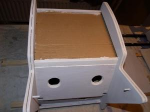

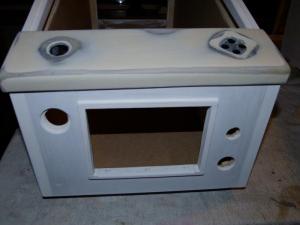

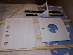

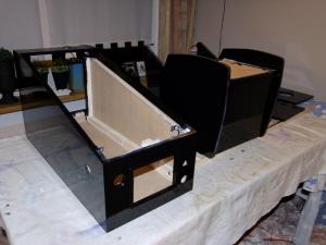

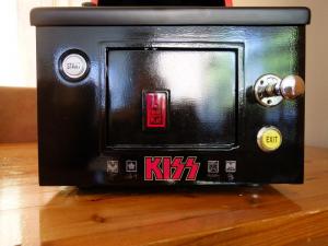

Superfrog Posted January 21, 2014 Author Posted January 21, 2014 Full Throttle ahead !!!!! Primer is done and first time wood filler 'not shown on pictures' is ready to dry. Tomorrow sandpaper time and first time color painting. See you

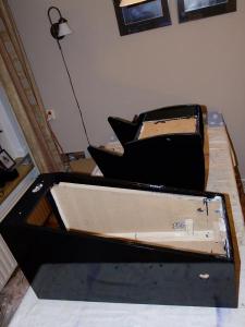

Superfrog Posted January 24, 2014 Author Posted January 24, 2014 At last..... the paintjob is ready .... Rest for a day to give it a good dry and then the fun part starts. Greetings to all !!

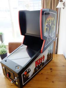

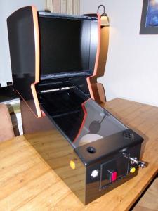

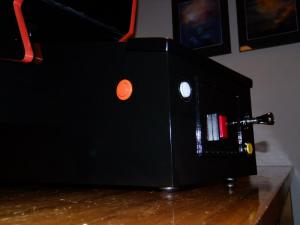

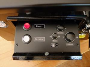

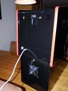

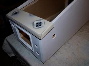

Superfrog Posted January 26, 2014 Author Posted January 26, 2014 It was a long day with working on the pinball bartop and installing a pc for my wife and install the laptop for the son.... Power-cord is soldered and speakers are placed. T-molding hammered on and buttons where they belong...... Lockdown bar and bezel strips have to be redone... I paint them satin black, to give it a little different look that I like. Maybe I change the plexi for glass.... Sleep well

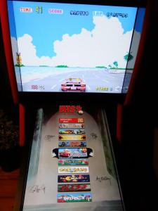

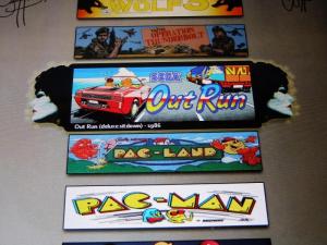

Superfrog Posted February 11, 2014 Author Posted February 11, 2014 Yessss, Finally after some big struggle with HyperPin, I moved over to PinballX and it worked FANTASTIC Here a quick result. List to do: Add more tables, design the KISS artwork for printing, add Mame and other emulators Enjoy Ps: Add a concept art for my kiss theme I worked on right now. I drop the South Park theme ..

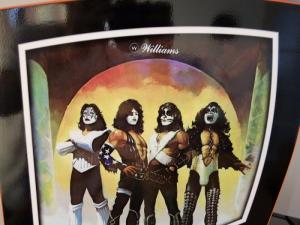

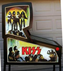

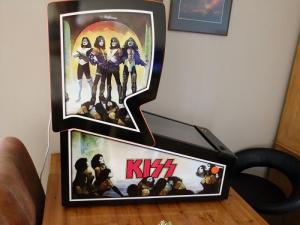

Superfrog Posted February 21, 2014 Author Posted February 21, 2014 Hell Yeah, With some KISS Alive II on the background, I put the final stickers on my pinball machine. It's a beauty if I may say so. The black paint is exactly the same as the glossy sticker, and before I put it on, I did go with a black marker around the side of the cutting line, so I don't got a little tiny white line. I'm not satisfied about the stickers on the inside of the coin door. Maybe I print a whole new sticker for that, but then I have a lot more work on that f......g coin door. Here some quick pictures for those who still like to see some KISS Back to designing the last couple of mala layouts... Greetings
Superfrog Posted March 6, 2014 Author Posted March 6, 2014 Hi there, I made a quick video of what the concept will be. Lots of reactions ( on other fora ) did not understand that I can play arcade games also on this one. I need to install more emulators and pinball tables and really a lot of tweaking before I can laydown the keyboard and fire it up with one button press..... Enjoy

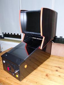

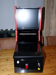

Superfrog Posted April 5, 2014 Author Posted April 5, 2014 Hi there, I finally got it finished. Here are 2 youtube links to show how the KISS Pinball/ Arcade bartop is working. Greetings Showcase Playing
richie_jones Posted April 6, 2014 Posted April 6, 2014 Looks great. Could you explajn a bit more on how you hacked the controller. Is it an xbox 360 controller. Easy to do?
Superfrog Posted April 9, 2014 Author Posted April 9, 2014 Looks great. Could you explajn a bit more on how you hacked the controller. Is it an xbox 360 controller. Easy to do? Thanks, It's just a pc usb gamepad with playstation looks;) I had some spare parts of a old xbox controller and attach it with the top of the xboxcontroller case where the buttons in place, with fiber glue onto the plexi lockdown bar. The same with the stick, cut the controller to fit in place and glue the whole thing. Simple yes, but a lot of work Good luck
