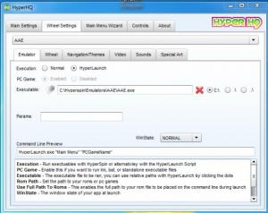

Here's all I can do right now. When I open Hyper HQ and click on Wheel Settings tab and select AAE I have two choices for Execution: Normal or Hyperlaunch. If I choose "normal" I can get to the AAE GUI from within Hyperspin. But it's just the AAE text on the main menu. There's no AAE preview video, no AAE wheel with games, videos etc. (all of which I have but can't get to work the way other emulators do). If I select the radio button for Hyperlaunch instead then I get an error when I try to launch from Hyperspin saying it can not find roms at [my roms location]. The next option in Hyper HQ is PC Game and that is set on Enabled and greyed out. Finally there is a blank for Executable location but no blank to create a link to the rom files (which the wheel settings page for MAME has, for instance). Also no blank for extensions on the AAE page.
Anyone have an idea how to get this to work the way it should?

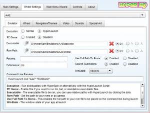

Okay, I fixed the problem in HyperHQ. Turned out I had created AAE wrong using the wizard. I deleted and recreated it. Now I have a wheel. And I was able to get video running by creating an AAE theme file of sorts.
But when I try to launch a game I'm getting a blank screen. I can get the AAE GUI if I go into Hyper HQ and switch Execution to "Normal" instead of "Hyperlaunch." But I can't get individual games to launch.

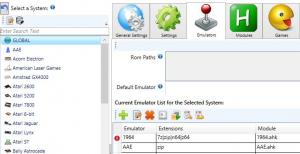

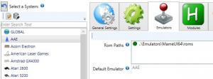

I think I got this figured out. I was using 7z for AAE which I guess is incompatible for some reason. Thanks to Deadly for posting those screenshots. That tipped me off what I was doing wrong. Now it seems to be working great.
