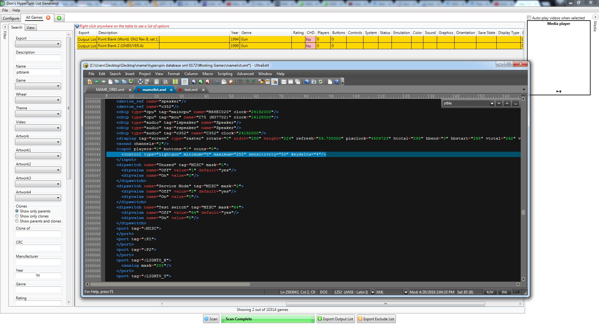

Im trying to use Don's list generator but after scanning my mame.xml, and it building the mamelist.xml, none of the attributes are transferred into the program itself.
For example, im trying to sort the lightgun games. As you can see from the attached screenshots, the mamelist.xml generated by the program does contain "<control type="lightgun" minimum="0" maximum="255" sensitivity="50" keydelta="4"/>"
However you can see from the screenshot that the Controls tab in don's program is empty. The genre, year is added, but none of the other important attributes that will be valuable to this process.Why is the program not synced with its own xml? Under the view tab everything is default, which means everything is checked aside from hide all / show all.
