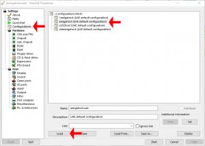

Switch on the controller, fire up WinUAE and load your config file.

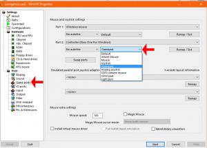

Once loaded choose "Game Ports" from the left pane.
Under "Port 2" select the controller you are using.
Where I have highlighted with the arrow change this from "Default" to "Gamepad" or other control type if required.

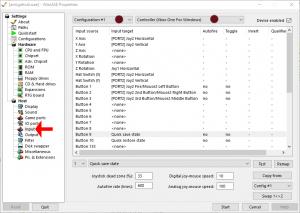

You can now go back to the config section and save it or further fine tune the controls by clicking "Input" in the left pane.
This should show at the top "config 1" and your controller, if not change it.

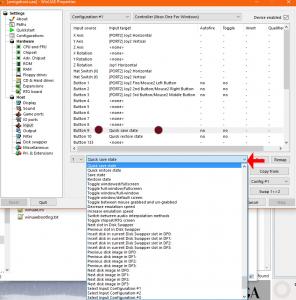

You can now add other actions to other buttons, as you can see I have Quick save and Quick Restore set to buttons 9 & 10.

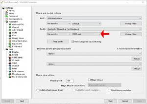

CD32 is the same but instead of choosing "Gamepad" from the drop down, choose "CD32 Pad" instead.
Don't forget to save the correct config.
