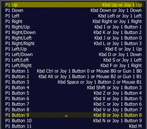

Cholsonic Posted May 13, 2016 Posted May 13, 2016 Hello All, I have a bit of a weird one! I have the Direct Input version of Mame 0.149, and have it working fine with Xpadder.. Well almost; The only mappings that won't work are the Coin input and Start buttons. Once coin inserted from keyboard and pressed start (from the keyboard) all the Xpadder mappings work great! Any ideas? I have tried using different keys for Coins and Starts and mapped those on Xpadder but get same results. I am thinking it may be that Coins and Starts are somehow *above* the input level that Direct Input works on ie. a machine input level over player input level, if that makes sense at all!! Note: I am using Xpadder because I have a tendency to have gamepads plugged into my cab all the time and Mame wants to use the gamepads as Player 1. Note2: I have tried ControllerRemap and was working great, but I found that some games (Asteroids and probably more) were not using the ControllerRemap profile - presumably because Asteroids defaults to using it's own mappings)

Cholsonic Posted May 13, 2016 Author Posted May 13, 2016 On 5/13/2016 at 2:16 PM, cataclysm67 said: When you have set the buttons for Coin and Start in XPadder, go to MAME.ini in your MAME emulator folder, then right click on it and tick read only. This will then save them. If you want to change any buttons on MAME again in future just remember to untick read only first, then tick again when you have changed buttons on XPadder. Hope this helps So the buttons are already set in xpadder, the keys are already set in mame. I made mame.ini and mameui64.ini read-only... Didn't work, although I am not sure if I understood your steps fully. Can you clarify please? Do I need to start over? On 5/13/2016 at 1:11 PM, kylecp1979 said: Have you tried a standard version of mame and not direct input? you can pick one up here http://mamedev.org/oldrel.html Yeah, I started on a standard version. NO xpadder keys recognised then. Now at least it's just the Coin and Start - although pretty frustrating as it's the first thing Ineed to press )
Cholsonic Posted May 13, 2016 Author Posted May 13, 2016 I have 2, 6 button joysticks with a start and select (shown as gamepad buttons 9 & 10) connected through one usb controller (Xin-mo something - I think). I can map the joysticks manually in mame and they work great... until I have another gamepad plugged in that takes the Player 1 spot.. I'll have to pick this up on Sunday now though as going away camping this weekend - see if there's any sun left !! If you have any further ideas, please let me know? Cheers
