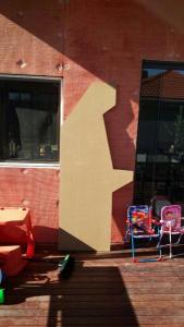

madrtr Posted February 1, 2014 Author Posted February 1, 2014 cut out the sides today for my cabinet build really happy with the height of it cant wait until next weekend to start constructing it together tapping it in with my s4
