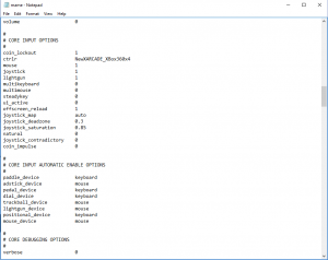

Here is my ini to help you out

coin_lockout              1
ctrlr                     x-arcade
mouse                     1
joystick                  1
lightgun                  1
multikeyboard             1
multimouse                1
steadykey                 0
ui_active                 0
offscreen_reload          0
joystick_map              auto
joystick_deadzone         0.3
joystick_saturation       0.85
natural                   0
joystick_contradictory    0
coin_impulse              0
# CORE INPUT AUTOMATIC ENABLE OPTIONS
paddle_device             mouse
adstick_device            mouse
pedal_device              mouse
dial_device               mouse
trackball_device          mouse
lightgun_device           keyboard
positional_device         keyboard
mouse_device              mouse
