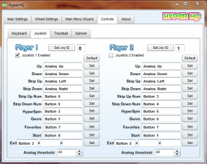

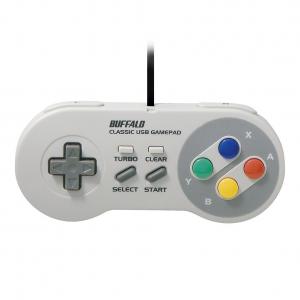

Hi! I'm a noob when it comes to Hyperspin And I'm wondering how do I configure my eight button SNES USB controller to run with HS? If it comes down to it all just open Hyper HQ a bunch of times and (very)slowly make adjustments to the button mapping... but if anyone could tell me what exactly the buttons do, it would make it a lot easier to map out. Here's a picture of my controller and a somewhat confusing Hyper HQ joystick mapping Menu.
up is up
down is down
skip up and down goes to the next letter in the alphabet
don't remember what skip number does
hyperspin spins the wheel to a random game
genre brings up your genres if you have it setup
favorites brings up favorites
start enters a wheel or starts a game
exit backs out of the menu
Yeah you just set your buttons to whatever you want them to be. Although I don't think HyperSpin spins to a random game. I wish it did that, but it only seems to spin the wheel faster than normal.
