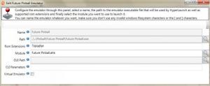

Cyberdeal98 Posted February 5, 2014 Author Posted February 5, 2014 32assasin, I followed your suggestion and did a fresh install of HyperSpin v1.3.2.0, HyperLaunch v3.0.0.9.9, and HyperLaunchHQ v1.0.13.0. All the latest updates. I went into HyperHQ and HyperLaunchHQ, and Future Pinball was listed in either one. So I went to HyperHQ and added Future Pinball as a wheel, then it showed up in HyperLaunchHQ. In HYperLaunchHQ I went to Global, and click Emulators and here's the settings: Name: Future Pinball Path: ..\..\Pinball\Future Pinball\Future Pinball.exe Rom Extensions: 7z|zip|fpt Module: Future Pinball.ahk I then clicked Future Pinball in HyperLaunchHQ, and under Emulators I added the FP table folder location (..\..\Pinball\Future Pinball\Tables\). In HyperLaunchHQ, and under Games I clicked Edit all Game, and the list was blank. So I went to D:\Games\HyperSpin - Fresh\Databases\Future Pinball and added a Future Pinball.xlm file: <?xml version="1.0"?> <menu> <header> <listname>Future Pinball</listname> <lastlistupdate>05/25/2013</lastlistupdate> <listversion>1.5</listversion> <exporterversion>zerojay - http://www.hyperspin-fe.com/forum/showthread.php?25239-Future-Pinball-Recreations-Clean-Set-2013-05-10-Database</exporterversion> </header> <game name="2001 (Gottlieb)" index="" image=""> <description>2001</description> <cloneof></cloneof> <crc>86106573</crc> <manufacturer>Gottlieb</manufacturer> <year>1971</year> <genre>Pinball</genre> </game> </menu> I went back to HyperLaunchHQ, and under Games I clicked Edit all Game, and the 2001 (Gottlieb) showed up in Green. I clicked the Launch selected game icon, and the Future Pinball program opened (not the table), then after 15-20 seconds I got an error message: "There was an error waiting for the window "ahk_class FuturePinballOpenGL". Please check you have the correct version emulator installed for this module, followed any notes in the module, and have this emulator working outside your Frontend first. Also turn off Fade to see if you are hiding your problem". Now I can't get past this error. Please help.

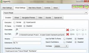

Cyberdeal98 Posted February 6, 2014 Author Posted February 6, 2014 32assasin, I got it to work!!!!!!!!!!!!!!!!!!!! Thank you so much. I've spend days working on this dang thing. Now I can relax. I went through all of your comments and links. I opened HyperHQ redid the Rom path, and clicked search subfolders enabled. Went to HyperLaunchHQ, and redid the Rom paths and launched it from there. I then opened HyperSpin and it worked. I get a few flashing screens while waiting for the table, but that 100000% better than where I was. Again, thank you!
