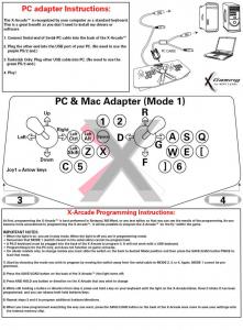

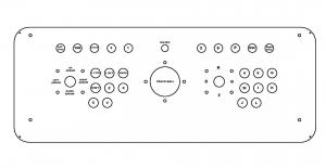

rmilyard Posted September 10, 2016 Author Posted September 10, 2016 Question for you all. So for MAME how should I setup buttons? The controller has 2 row of 3 buttons and 1 row of 2. So in MAME should I do 1-8? Heard somewhere do 1-6 skip 7-8 for last 2 buttons and setup as 9 and 10. Not sure what is best setup. Then guess so whatever is best for player 2.

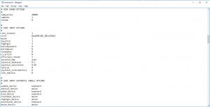

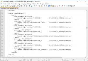

kylecp1979 Posted September 10, 2016 Posted September 10, 2016 Your controller should already be set up for mame. The only thing you might want to change is when it loads up neo geo games to use 4 buttons straight across. You can do that pretty easy by using the NewXARCADE_XBox360x4.cfg in your ini file but I think you'll have to change a few buttons or you could make a cfg file and put it in your ctrlr folder and use that in your mame ini file.
GameGuy14 Posted October 1, 2016 Posted October 1, 2016 Thanks for the above thumbnails. I just ordered a cabinet from rec room masters yesterday with the same xtensions emulator edition controls. Itll be here in a month(due to my work schedule) but I can spend some weekend time setting up Hyperspin to reflect these controls. Or I guess Mame would already be set to this?
