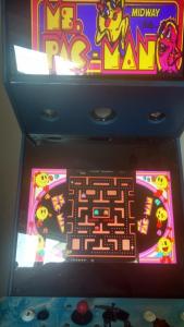

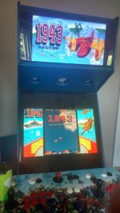

danwelsh Posted June 20, 2016 Author Posted June 20, 2016 One more thing I noticed Metalzoic is some of the games the score board/insert coin is right where it should be but others it isn't, you can see with the attached pics what I mean.....1943 is perfect, Ms PAC man not so much.....how can I fix this? I'm lovin my arcade
Metalzoic Posted June 20, 2016 Posted June 20, 2016 I just use adjustments to HLSL and GLSL to get the sizes to fit how I like. Don't remember how exactly though... maybe it was horizontal/vertical stretch to make midro adjustments to games that needed it? Been awhile since I did it. You could also adjust the bezel.ini's to squish the game area down a bit more, but that would require re-working the entire pack and I didn't want the games reduced from full-size as default. EDIT: I believe it is horizontal & vertical stretch adjustments, just like on my real arcade machines.
