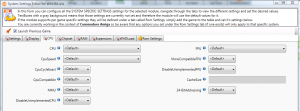

aniasz Posted July 24, 2015 Posted July 24, 2015 OK, at this moment I have so if I file * .uae for a particular game configuration takes off and runs WinUAE as I set. otherwise WinUAE starts with cycle-exact (which can not be). display settings, sound, controllers are ok in the case of emulation Amiga 1200 did not work my way with a * .uae in configuration, ie, display settings, sound, controllers are ok, but starts with cycle-exac
rfancella Posted July 24, 2015 Author Posted July 24, 2015 Ok, Go into your Module Settings for WinUAE. Click on the CPU tab and set CpuCycleExact to false. Thanks, Ron OK, at this moment I have so if I file * .uae for a particular game configuration takes off and runs WinUAE as I set. otherwise WinUAE starts with cycle-exact (which can not be). display settings, sound, controllers are ok in the case of emulation Amiga 1200 did not work my way with a * .uae in configuration, ie, display settings, sound, controllers are ok, but starts with cycle-exac Code Monkey and all around Command Line geek!If you like what someone has said or done for you, be sure and 'Thank' them. And if they changed your life, send them a Beer!
aniasz Posted July 24, 2015 Posted July 24, 2015 Ok, Go into your Module Settings for WinUAE. Click on the CPU tab and set CpuCycleExact to false. Thanks, Ron hello, Ron! thanks for the help is actually an option in the system settings editor for WinUAE.whk but for each game individually. It can not be applied globally to all the setting was that? when I click Global Settings pops up a message - the module does not make use of a global settings file ... thanks
rfancella Posted July 24, 2015 Author Posted July 24, 2015 Right. It is there for both as well. For some reason this module uses the "Edit System Specific Module Settings" instead of the "Edit Global Module Settings" button. When you hit the "...System Specific..." button for the WinUAE.ahk module you are presented with a bunch of tabs: In the picture above I have selected the CPU tab. Everything on all the tabs, except those in the Rom Settings tab, apply to all the games for this speciffic system. So change the CpuCycleExact to false and it should be set to false for all games except for those you have otherwise set to true in the Rom Settings tab. Thanks, Ron hello, Ron!thanks for the help is actually an option in the system settings editor for WinUAE.whk but for each game individually. It can not be applied globally to all the setting was that? when I click Global Settings pops up a message - the module does not make use of a global settings file ...thanks Code Monkey and all around Command Line geek!If you like what someone has said or done for you, be sure and 'Thank' them. And if they changed your life, send them a Beer!
aniasz Posted July 24, 2015 Posted July 24, 2015 Right. It is there for both as well. For some reason this module uses the "Edit System Specific Module Settings" instead of the "Edit Global Module Settings" button. When you hit the "...System Specific..." button for the WinUAE.ahk module you are presented with a bunch of tabs: Screenshot - 7_24_2015 , 2_22_39 PM.png In the picture above I have selected the CPU tab. Everything on all the tabs, except those in the Rom Settings tab, app Right. It is there for both as well. For some reason this module uses the "Edit System Specific Module Settings" instead of the "Edit Global Module Settings" button. When you hit the "...System Specific..." button for the WinUAE.ahk module you are presented with a bunch of tabs: Screenshot - 7_24_2015 , 2_22_39 PM.png In the picture above I have selected the CPU tab. Everything on all the tabs, except those in the Rom Settings tab, apply to all the games for this speciffic system. So change the CpuCycleExact to false and it should be set to false for all games except for those you have otherwise set to true in the Rom Settings tab. Thanks, Ron I do not have these tabs ... I have only the Settings tab and rom settings I do not know how to insert a print screen to show youly to all the games for this speciffic system. So change the CpuCycleExact to false and it should be set to false for all games except for those you have otherwise set to true in the Rom Settings tab. I do not have these tabs ... I have only the Settings tab and rom settings I do not know how to insert a print screen to show you
