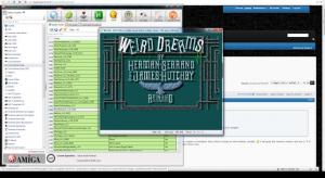

Hey buddies,
When I try to play Weird Dreams I get the error after a black screen. "OPCODE4 EAE FAULTY PREFETCH" or something to that effect. Anybody have any ideas?
I can at least confirm it's working. Do you have other games working? Check the Rom, perhaps?
I have in window mode to see if bezels work. I think it's a no on that one, hopefully bleasby will be added it.
Moonstone and some other Roms work. I downloaded the set that you had recommended in another thread. It starts off, weird dreams. Slave. Then black screen, nothingness and my error. Maybe it's my kickstart Roms. I downloaded the tosec ones?
If you open the archive is there 1 file in it with a .lha extension?

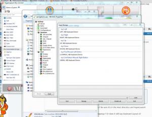

Ron and co.....driving me up the wall with the key mapping to my ipac2.... I have worked out how to remap the keys and can set up a custom mapping mapped to my joystick / mouse / buttons etc.
However, I can't get it to save. I'm obv doing something stupid. If I quit out of WinUAE and back in again there is no sign of my custom map and it has reverted to the standard ones. I have tried hitting save in the config section too..
Any help much appreciated as ever...
Paul
Hmm. I think as long as I save it in configurations and then reload amigahost.uae it's there... the option to make it autoload it is greyed out though?
When I load a game though I can only play it with the default keys (i.e) my number pad with 5 for fire...
not my remapped Ipac..any ideas??
Did you save the amigahost.uae file in your ...\WinUAE\Configurations\Host directory? Be sure it's in the Host directory and HyperLaunch should load it when the game is launched.
Also, when you reload the configuration, does the Port setting now say <Custom Mapping>? Or does it still say Keyboard Layout A?

It wasn't saving in the /host directory but it is now.... still struggling to be honest...
If I load WinUAE my amigahost.uae doesn't autoload - is that correct? But if I select it and load it it reloads my settings and shows my gameport as custom mapped (the image is how I have it set up with my iPac)
I actually had it set until recently on Mouse but I assume now that needs to be set on joystick and it gave me the correct options to map which I did.
So testing that in WinUAE remapper thing it looks fine...
Load a game through hyperlaunch and it loads fine but my Ipac "joystick" doesn't work...,my mouse however does, left button works as fire and I can move characters around etc...however, I thought I had disabled it in WinUAE by having no second port....
Any ideas mate, I'm obv doing something simple wrong I think.....
Paul
The above is correct.
Paul
Normally, for most Amiga games, you leave the mouse plugged into port 1 and your joystick is port 2. So, leave the mouse setup in port 1 and configure your IPac as a joystick in port 2. Be sure and save your settings in ...\Host\amigahost.uae.
Thanks,
Ron
Goodness, that's sorted it out, thanks a lot.. :-)
