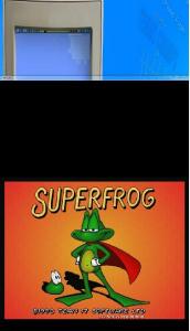

Weird...
I don´t have them, only \Bezels\_Default
Is all good. Then it's the bezels in there it's using. So, you could download some bezels for Amiga, there are some nice ones out there. But that may not be the issue if you haven't changed any of the files in there.
Try this...
Turn off bezel support for this system. Then open up your WinUAE. Load your amigahost.uae file and click on Display on the left. Set your windowed resolution there. Save the setting back over your ...\Host\amigahost.uae file and test. Let me know what it looks like. That will tell you if your amigahost settings are correct.
Then post your HyperLaunch.log here.
Thanks,
Ron
This will be my last post for today, getting late again.
Now it looks like this
Is this the correct logtype?
[ATTACH=CONFIG]44383[/ATTACH]

Well, thank you for taking your time and try to help me! :)
Where, were, ware - it´s not my thing, don´t remember when to use which
Raccoon,
Ok, I see in the logs, it's currently set in HLHQ for FullScreen=False.
I appologize, I thought you were using the modified module to use bezels. I was seeing what looked like a bezel in the background. So, without the modified module, it will be either windowed or fullscreen.

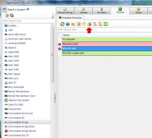

Open up HLHQ and click Commodore Amiga on the left.
Click Modules on the top.
You should be using WinUAE.ahk as your default, so select it in the list.
Click the button "Edit System Specific Module Settings".
Make sure that "Fullscreen" is set to "true".
Test and advise.
Thanks,
Ron
YES!
Now it works perfectly!
Thank you so much! :)

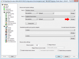

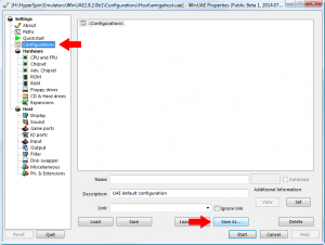

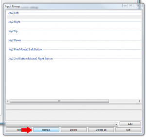

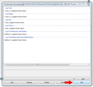

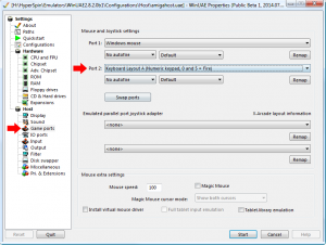

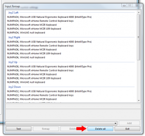

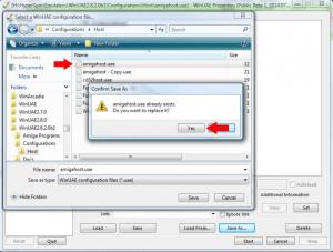

Ok, there have been quite a few questions about how to re-map your controls in WinUAE. This applies to both Commodore Amiga and Commodore Amiga CD32.
If you already have everthing setup and working, but need to adjust or set your controls, this is the post for you! :D
Because HyperLaunch load the file in your ...\Configurations\Host directory called amigahost.uae (for Amiga) and cd32host.uae (for Amiga CD32) all the changes need to be made to that files.
Please follow these steps to change them.

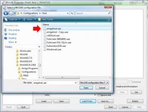

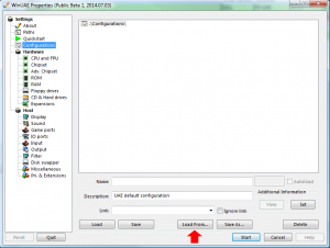

You must first launch the emulator outside HyperSpin and HyperLaunch. For that I recommend launching HyperLaunchHQ and do it from there.
Click Commodore Amiga on the left and Modules on top.
Find WinUAE.ahk in the list and click on it. Click the "Launch Emulator" button right above it as shown below:
This will launch WinUAE.
Click "Configurations" on the left and hit the "Load From..." button on the bottom as shown below:
You should get a file requester that starts in the Configurations directory. Double click Host and then double click the file amigahost.uae as shown below:
You should now be at the WinUAE main screen with the proper configuration file loaded.
Now, click on "Game ports" on the left and change your "Port 2:" controller as shown below:
If you are OK with the default settings for that controller, skip down to the section below "Saving The Config".
To remap the controls, hit the "Remap" button as shown below:
This will take you to the "Input Remap" screen. Hit the "Delete all" button as shown below to clear out all the mapping:
The screen will now show every mapping removed.
Hit the "Remap" button to set it all up:
It will then prompt you for each key/button.
Once done, hit the "Exit" button:
You should now be back to the main WinUAE screen and your ready to save your new configuration.
Saving The Config:
Click on "Configurations" on the top left. Then hit the "Save As..." button on the bottom as shown below:
To save over your old configuration, double click on the Host directory and then double click on the file amigahost.uae.
It will ask if it's ok to save the file over the old one. Hit the "Yes" button as shown below:
Done!

In HLHQ, select Commodore Amiga on the left.
Then Modules on top.
Then select WinUAE.ahk and hit the "Edit System Speciffic Module Settings" button.
In the new window, click on the Rom Settings tab.
