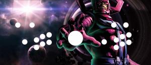

The control panel graphic is set up but I'm holding off until I get the joysticks (sanwa j-stiks) installed so I can double check measurements on this before ordering.
