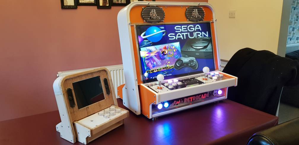

Robthejog Posted March 16, 2018 Posted March 16, 2018 Hi Richie, This is awesome! I’m planning on building my own cabinet and googled ‘DIY Nugen style arcade cabinets’ - which brought me here. Funnily enough I’m just down the road from you in Flint! Quick question: how did you get such a quality paint finish? Was it a painstaking process of sanding, filling and repeat? What paint did you use, if you don’t mind me asking? Thanks
richie_jones Posted March 22, 2018 Author Posted March 22, 2018 Hi Rob, Great to here your nearby.. All the pieces were covered in 3m car vinyl, if you fill and prime your wood then sand smooth before sticking you vinyl it looks as good as high quality paint. Never any orange peel and i find it quite hard wearing. If you did choose to do this method its best to plan where you seems are hidden, for example the side pieces that hold the control panel the join is hidden in the t moulding groove you couldn't wrap a whole 2 sided piece completely in one piece vinyl, if that makes sense..
Robthejog Posted May 6, 2018 Posted May 6, 2018 On 22/03/2018 at 8:13 PM, richie_jones said: Hi Rob, Great to here your nearby.. All the pieces were covered in 3m car vinyl, if you fill and prime your wood then sand smooth before sticking you vinyl it looks as good as high quality paint. Never any orange peel and i find it quite hard wearing. If you did choose to do this method its best to plan where you seems are hidden, for example the side pieces that hold the control panel the join is hidden in the t moulding groove you couldn't wrap a whole 2 sided piece completely in one piece vinyl, if that makes sense.. Genius! I’ll definitley consider using vinyl for my build. Thanks for the tip Richie
richie_jones Posted June 20, 2018 Author Posted June 20, 2018 Smaller build with an xu4 hopefully.. see through as per the first..All wiring and components will be on show so custom cables for everything.

richie_jones Posted June 22, 2018 Author Posted June 22, 2018 I've experimented with a pi 3 and wasn't that impressed with it's performance.. Hopefully the xu4 will be better, still waiting for it to arrive..
