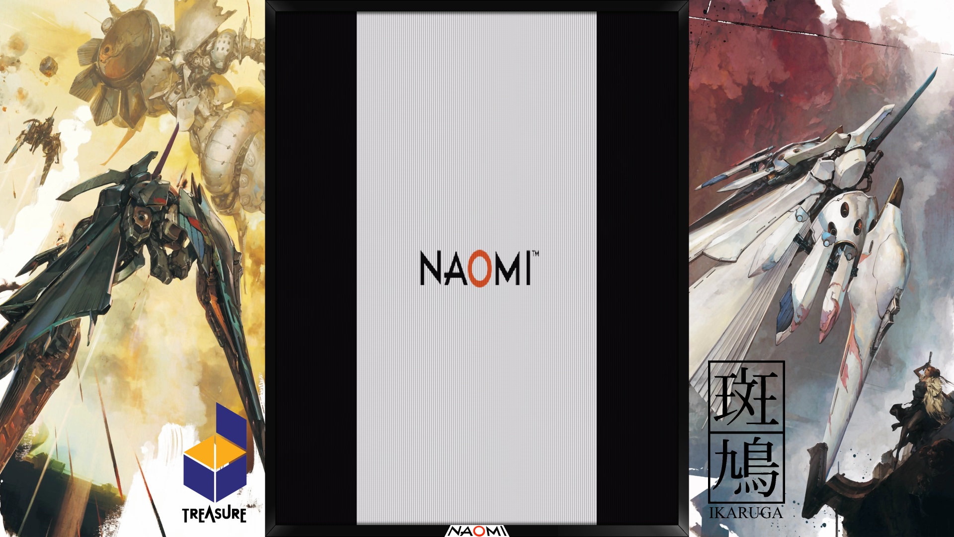

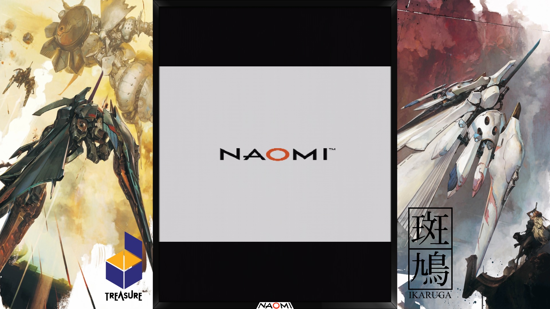

griffin518 Posted July 29, 2016 Posted July 29, 2016 I posted this to the RL forums but thought I'd try here as well... Look at the issue I'm having when bezels are enabled with Ikaruga. Could someone else confirm? Has anyone seen and solved this? It stretches the display area using DX11old, and squishes the display area using DX11 (new). Here are some screenshots... gpuDX11old gpuDX11 Download my RocketLauncher bezels: http://hyperspin-fe.com/files/file/14367-griffin518s-bezel-depot/ Best of MAME HyperSpin XML: http://www.hyperspin-fe.com/files/file/11710-griffin518s-best-of-mame-xml-database/ Best of MAME bezel pack: http://www.hyperspin-fe.com/files/file/11711-griffin518s-best-of-mame-bezel-pack/ Custom MAME ini files w/HLSL settings: http://www.hyperspin-fe.com/files/file/11712-griffin518s-best-of-mame-mameuifx-ini-files/
m4me Posted July 29, 2016 Posted July 29, 2016 Having the screen size set in the bezel .ini squishes it. For my 1920x1080 screen i have this is my ini: [General]Bezel Screen Top Left X Coordinate=0Bezel Screen Top Left Y Coordinate=0Bezel Screen Bottom Right X Coordinate=1920Bezel Screen Bottom Right Y Coordinate=1080 You may have to mess with the setting to create the gaps for top and bottom but maintain that ratio. I have my window size to 1920x1080 and aspect to 4:3. I've only tested for 4:3 games though, my vertical games were loading weird when i set up the system so i left them out before i started making the bezels. EDIT: Nevermind, having a bezel set in the ini and then turning on stretch works fine. I can actually set my vertical games up now
griffin518 Posted July 29, 2016 Author Posted July 29, 2016 That did the trick, thanks. I missed that option in the module settings. Shame you need to configure per game for some of them. Oh well! Download my RocketLauncher bezels: http://hyperspin-fe.com/files/file/14367-griffin518s-bezel-depot/ Best of MAME HyperSpin XML: http://www.hyperspin-fe.com/files/file/11710-griffin518s-best-of-mame-xml-database/ Best of MAME bezel pack: http://www.hyperspin-fe.com/files/file/11711-griffin518s-best-of-mame-bezel-pack/ Custom MAME ini files w/HLSL settings: http://www.hyperspin-fe.com/files/file/11712-griffin518s-best-of-mame-mameuifx-ini-files/
