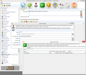

I've added a new console on the wheel " Sega Saturn Japan" I've then selected the emulator i want to use which is SFF and added the rom extensions but when i select search for the module its only giving the option for RetroArch? How do i get it to add SFF.ahk.
I've attached a screen shot to show.

Click the RocketLuancher UI Tab (last tab with the big orange circle)
Under General options, uncheck Valid Emulators/Modules Only
That will allow you to pick whichever module you want.
or better yet,  you should set up SSF as a global emulator,  NOT AS A SYSTEM EMULATOR
do what Styphelus said,  and use the SSF global from the emulator selection.
edit
you might not even need to do that since you don't have a custom name for your Sega Saturn Japan system
if you set up SSF as a Global emulator for Sega Saturn,  you can use the same Global emulator for Sega Saturn Japan.

Thanks for your help with this one ive managed to add Sega Saturn Japan & Dreamcast Japan. Cheers :)
Now how do i add the icon`s \ pic to the console name on the left side (see pic attached)
