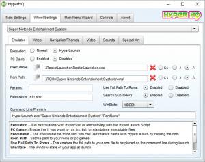

ryanjg11 Posted August 24, 2016 Posted August 24, 2016 I've configured RocketLauncherUI to set HyperSpin as the default frontend. I've also gone into the HyperSpin Settings.ini and set "Hyperlaunch_Path=E:\RocketLauncher\RocketLauncher.exe." I have no problem launching games directly from RocketLauncherUI, but when I attempt to launch the game in HyperSpin, I can browse games, but when I click Start to launch them, nothing appears to happen. I've taken a screenshot of my HyperHQ screen for SNES and attached it here. And here is my directory structure... Everything is on the E drive: E:\HyperSpin E:\RocketLauncher E:\ROMS\Super Nintendo Entertainment System\roms I'm using relative paths as I would like to make this entire setup portable such that I can move it to my HTPC at a later time. Any idea what might be causing the issue here? I noticed that HyperLaunch.exe was still listed in the HyperHQ command line... Shouldn't that be RocketLauncher.exe?

32assassin Posted August 24, 2016 Posted August 24, 2016 from your attachment - their is no need for you to add an emulator path to your HyperHQ settings. this is has been phased out (since you are using RL). And if you where using them; you would add a path to your emulator not to RL, that path is not needed and its wrong unless you are using Hyperspin 1.3.3. Since you have your launcher Set to Hyperlaunch not Normal. This path is redundant. - their is also no need for you to add rom paths to your HyperHQ settings. unless you are using rom filters. both of this settings are saved in your Rocketlauncher INI files. if you can launch a game in RLUI but you cannot load it directly from Hypespin. Chances are that Hyperspin is not communicating with RL post your Hyperspin Log found at E:\HyperSpin\log.txt
