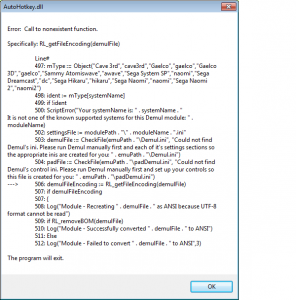

doohan Posted August 28, 2016 Posted August 28, 2016 Hi Everyone, I try to setup Demul 0.7 in my cab for Naomi and Atomiswave systems.Everything is running fine outside Hyperspin.I've set the emulator ready and picked up modules on the web (Cab is not linked on the web so I cannot update Rocketlauncher automatically).When I try to run a game in Rocketlauncher, I have this error message (in attachment) for both systems. Any idea?
gigapig Posted August 28, 2016 Posted August 28, 2016 Sorry Doohan those Autohotkey errors are caused by something being out of date and it may not be the module. Is there no way to connect to the Internet or up date on another machine and transfer. You are a platinum member so you could download the 60 system build and transfer files from there. Just be careful what you transfer though and backup what you have already.
doohan Posted August 28, 2016 Author Posted August 28, 2016 Sorry Doohan those Autohotkey errors are caused by something being out of date and it may not be the module. Is there no way to connect to the Internet or up date on another machine and transfer. You are a platinum member so you could download the 60 system build and transfer files from there. Just be careful what you transfer though and backup what you have already. Hi Gigapig, As the cab wa done by DreamHomeArcades, there are specific things I cannot touch... I took the last modules of Rocketlauncher for Demul 0.7 and set it in the right folder. Except Emulator and Modules, are there other things to update? Thanks and regards,
gigapig Posted August 28, 2016 Posted August 28, 2016 Hi Gigapig, As the cab wa done by DreamHomeArcades, there are specific things I cannot touch... I took the last modules of Rocketlauncher for Demul 0.7 and set it in the right folder. Except Emulator and Modules, are there other things to update? Thanks and regards, Someone else may know specifically, the only one I can think of is the Libs folder. You could post your RL log.
Guest Posted August 28, 2016 Posted August 28, 2016 Hi Gigapig, As the cab wa done by DreamHomeArcades, there are specific things I cannot touch... I took the last modules of Rocketlauncher for Demul 0.7 and set it in the right folder. Except Emulator and Modules, are there other things to update? Thanks and regards, Unfortunately it doesn't work like that. You can't just take an updated module file and drop it in without updating the other files. The new module will be calling for things in the rest of the RL scripts that aren't there because they haven't been updated. I'd suggest in this instance you contact the guys that made the arcade for a solution to connect the cab to the internet. It just isn't going to work any other way. You could run a RL setup on another machine, which can be updated and copy the files over each time. You'll have to be extremely careful here as if you copy over settings ini files - you'll wipe the setup on the cab. In short, you've gotta update all of RL at once, dropping in new modules won't work. Sent from my iPhone using Tapatalk
doohan Posted August 28, 2016 Author Posted August 28, 2016 Unfortunately it doesn't work like that. You can't just take an updated module file and drop it in without updating the other files. The new module will be calling for things in the rest of the RL scripts that aren't there because they haven't been updated. I'd suggest in this instance you contact the guys that made the arcade for a solution to connect the cab to the internet. It just isn't going to work any other way. You could run a RL setup on another machine, which can be updated and copy the files over each time. You'll have to be extremely careful here as if you copy over settings ini files - you'll wipe the setup on the cab. In short, you've gotta update all of RL at once, dropping in new modules won't work. Sent from my iPhone using Tapatalk Hi Guys, Thanks for you replies. I've seen on the Web that there are effectively many folders and exe impacted.... I'll asl DreamHomeArcade if they can handle it. Thanks and regards,

doohan Posted August 28, 2016 Author Posted August 28, 2016 OK, Updates seem to be done. I have now 3 files (config, ahk and isd) for the Module Demule 0.7 Think I have to rename Demul (v0.7) (Example) in Demul (v0.7), right? Once confirmed, I'll replace the files on my cab and see if Naomi and Atomiswave start Thanks and regards,
doohan Posted August 28, 2016 Author Posted August 28, 2016 OK, Updates seem to be done. I have now 3 files (config, ahk and isd) for the Module Demule 0.7 Think I have to rename Demul (v0.7) (Example) in Demul (v0.7), right? Once confirmed, I'll replace the files on my cab and see if Naomi and Atomiswave start Thanks and regards, Thanks to veryone who helped me. Updating Rocketlauncher on my personal computer and replacing the files on my cab work! I just needed to force the DirectxOld for everygame or Atomiswave zoomed too much and to replace in the Jamma for both players the key buttons from the one found in the DemulPad.ini or Rocketlauncher overwrote the key configuration. Now it solved and everything seem to work fine.
