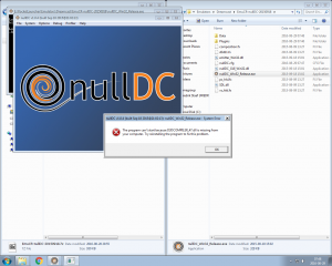

Dime333 Posted August 29, 2016 Posted August 29, 2016 I get this error message when trying to start NullDC. I have installed every version of DirectX that I could find. Can someone help me out here?
gigapig Posted August 29, 2016 Posted August 29, 2016 That's a weird one, it seems that file is only available in the Windows 8.1 SDK and Visual Studio.
gigapig Posted August 29, 2016 Posted August 29, 2016 Here is the file from my Windows 10 x64 machine which was found in C:\Windows\System32 D3DCompiler_47.rarFetching info...
Dime333 Posted August 29, 2016 Author Posted August 29, 2016 Thanks. Here's something even weirder. I have just installed a new SSD disk so I have a new install of windows 7. I'm testing all systems and fixing issues. Dreamcast using nullDC was slow in fullscreen but was fine in windowed mode. I tried running the emu without RL and got an error that I later learned was just that it couldn't find the default ISO. So there really was no problem. But before I knew that, I found a build from 2015 and installed that in my Nulldc folder. Then I got this error. Even on the version that ran before. Very strange. I downloaded the file and put it in the NullDC folder and that does work. But there must be a better way. There must be a specific version of directX that needs to be indstalled. I'm gonna start another thread for the slow fullscreen issue. It's really weird. I'm using the same settings as I used to. I've tried changing everything but it still happens. I suspect a driver issue. I'll keep an eye on nvidia's driver site.
