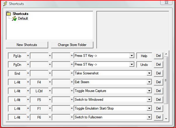

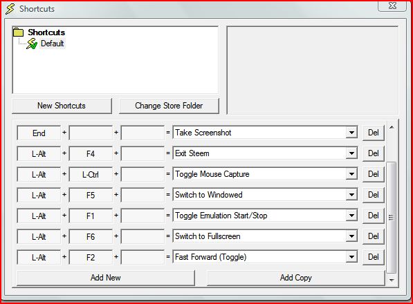

When you open steem and the "shortcuts" (lighning bolt) dialog you should see somthing similar to the attached .jpgs below.
also while in the "shortcuts" dialogue, you should be able to re-edit the keys to the ones you want to use. (F12 for fullscreen maybe?)
[default.stcut]
[shortcuts]
Shortcut0_ID1=33
Shortcut0_ID2=65535
Shortcut0_ID3=65535
Shortcut0_Action=0
Shortcut0_Key=33
Shortcut0_Char=0
Shortcut0_MacroFile=
Shortcut1_ID1=34
Shortcut1_ID2=65535
Shortcut1_ID3=65535
Shortcut1_Action=0
Shortcut1_Key=34
Shortcut1_Char=0
Shortcut1_MacroFile=
Shortcut2_ID1=35
Shortcut2_ID2=65535
Shortcut2_ID3=65535
Shortcut2_Action=29
Shortcut2_Key=65535
Shortcut2_Char=0
Shortcut2_MacroFile=
Shortcut3_ID1=164
Shortcut3_ID2=115
Shortcut3_ID3=65535
Shortcut3_Action=23
Shortcut3_Key=65535
Shortcut3_Char=0
Shortcut3_MacroFile=
Shortcut4_ID1=164
Shortcut4_ID2=162
Shortcut4_ID3=65535
Shortcut4_Action=9
Shortcut4_Key=65535
Shortcut4_Char=0
Shortcut4_MacroFile=
Shortcut5_Action=16
Shortcut5_ID1=164
Shortcut5_ID2=116
Shortcut5_ID3=65535
Shortcut5_Key=65535
Shortcut5_Char=0
Shortcut5_MacroFile=
Shortcut6_ID1=164
Shortcut6_ID2=112
Shortcut6_ID3=65535
Shortcut6_Action=3
Shortcut6_Key=65535
Shortcut6_Char=0
Shortcut6_MacroFile=
Shortcut7_Action=15
Shortcut7_ID1=164
Shortcut7_ID2=117
Shortcut7_ID3=65535
Shortcut7_Key=65535
Shortcut7_Char=0
Shortcut7_MacroFile=
Shortcut8_ID1=164
Shortcut8_ID2=113
Shortcut8_ID3=65535
Shortcut8_Action=51
Shortcut8_Key=65535
Shortcut8_Char=0
Shortcut8_MacroFile=
Shortcut9_Action=255
