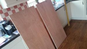

I have finally took the plunge and bought my playfield a 42" LED Samsung TV also my 18mm marine plywood for the cabinet, the playfield will fit nicely into a Williams wide-body plan cabinet with 8cm to spare either side my worry is the cabinet length is 1274mm and the TV is 970mm should I cut down the cabinet to accommodate the playfield slightly?
Also how far forward should the LED screen be from the front of the cabinet because of the lock down bar thanks in advance.
