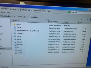

The mame.ini file is in a folder called ini within the mame folder that has the mame.exe and everything else in... Is this right?
There are other ini files in there like horizont vertical etc. I'll post some pics
I've set everything as it should be in the mame.ini as far as I know...

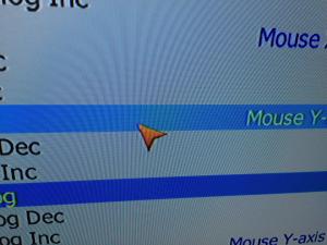

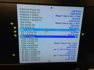

When I TAB in a game, player 1 controls etc.. Click on track X analog then move the trackball so it picks it up I just get this...
When I click to set track analog, move Te trackball, the orange curser appears as it does if I move a normal mouse, then the TAB menu seems to freeze? Have to esc back to hyperspin.

Have you tried it in Mouse Analog? Track Analog? or Dial Analog?
  On 9/29/2016 at 10:02 PM, Martin0037 said:
Tried in track analog and dial analog. As soon as I move trackball that orange curser appears
When configure X axis just make ball go up and down continuos. And when configure Y axis left and right till it appears in config.
For the Spinner just one Axis.

I've noticed there is no mame.ini file in the same folder as the mame.exe. It's in a folder called "ini"
Everything I've googled suggested there should be mame.ini in the mame folder where mame.exe is? Or is this just for older/different versions?
Tried trackball and soon as I move it it just pops up with the orange curser. I'll try on all track etc devices.

You have to create mame.ini  by executing (from command line for example):   mame(64).exe -cc
Then modify options for trackball as told
and after that configure in a Trackball game (Some bowling games uses trackball).
  On 9/30/2016 at 10:03 AM, Martin0037 said:
Sorry, might be me being thick with computers but I've got no idea how to do that...
You have to open a console (by going to Windows Start Menu and typing   cmd.   Then go to the folder where you have MAME emulator for example:   D:\Emulators\MAME\mame64.exe (or mame.exe). And type:   mame64.exe -cc (or mame.exe -cc)
that's it! With this you'll create the mame.ini config you need.
