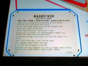

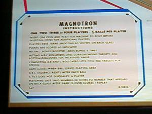

I started exactly with the same question 2 years ago to build my cab. For the 2nd monitor I choosed the VGA- way - today I can say a clear mistake! Why? most of the better grafic cards do not have a VGA output and if they have (in my case a GTX750), the best possible resultion is lesser than on digital interfacing. See attached pics when I switched the playfield from VGA to HDMI.
VGA:
HDMI
