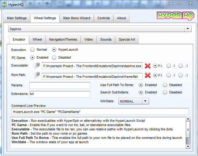

Haloman800 Posted September 30, 2016 Posted September 30, 2016 Long story short, I need to launch Daphne with command lines in order for my screen orientation to be proper; Here is the cmd code that Daphne gave me: daphne.exe dle21 vldp -framefile "F:\Hyperspin Project - The Frontend\Emulators\Daphne\framefile\lair.txt" -ignore_aspect_ratio -blank_searches -min_seek_delay 1000 -seek_frames_per_ms 20 -homedir "F:\Hyperspin Project - The Frontend\Emulators\Daphne" -useoverlaysb 2 -bank 0 11011000 -bank 1 00110111 -sound_buffer 2048 -fullscreen -x 1024 -y 768 -opengl And this is a photo of my current setup: Let me know if you need more clarification.
Metalzoic Posted September 30, 2016 Posted September 30, 2016 Are you running it through HS instead of RocketLauncher? Have you tried turning that command line into a Bat file to see if it launches correctly? Sent from my SM-G935V
Haloman800 Posted October 1, 2016 Author Posted October 1, 2016 Are you running it through HS instead of RocketLauncher? Have you tried turning that command line into a Bat file to see if it launches correctly? Sent from my SM-G935V I'm running it through HyperLaunch 2.25c. Running it as a .bat file does nothing. The text on the cmd prompt closes too fast for me to read it, but it doesn't launch any game or program.

Haloman800 Posted October 1, 2016 Author Posted October 1, 2016 nexusmtz on ArcadeControls forums figured it out! All I had to do was open Hyperspin > Modules > Daphne > Settings.ini, at the top under globalParams, I added -x 1024 -y 768 -opengl And it works!
