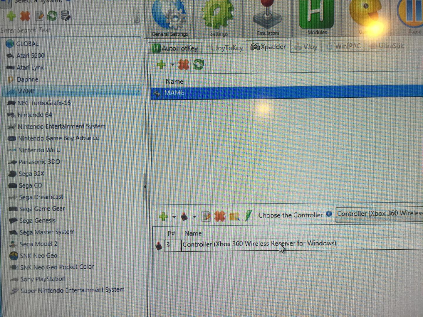

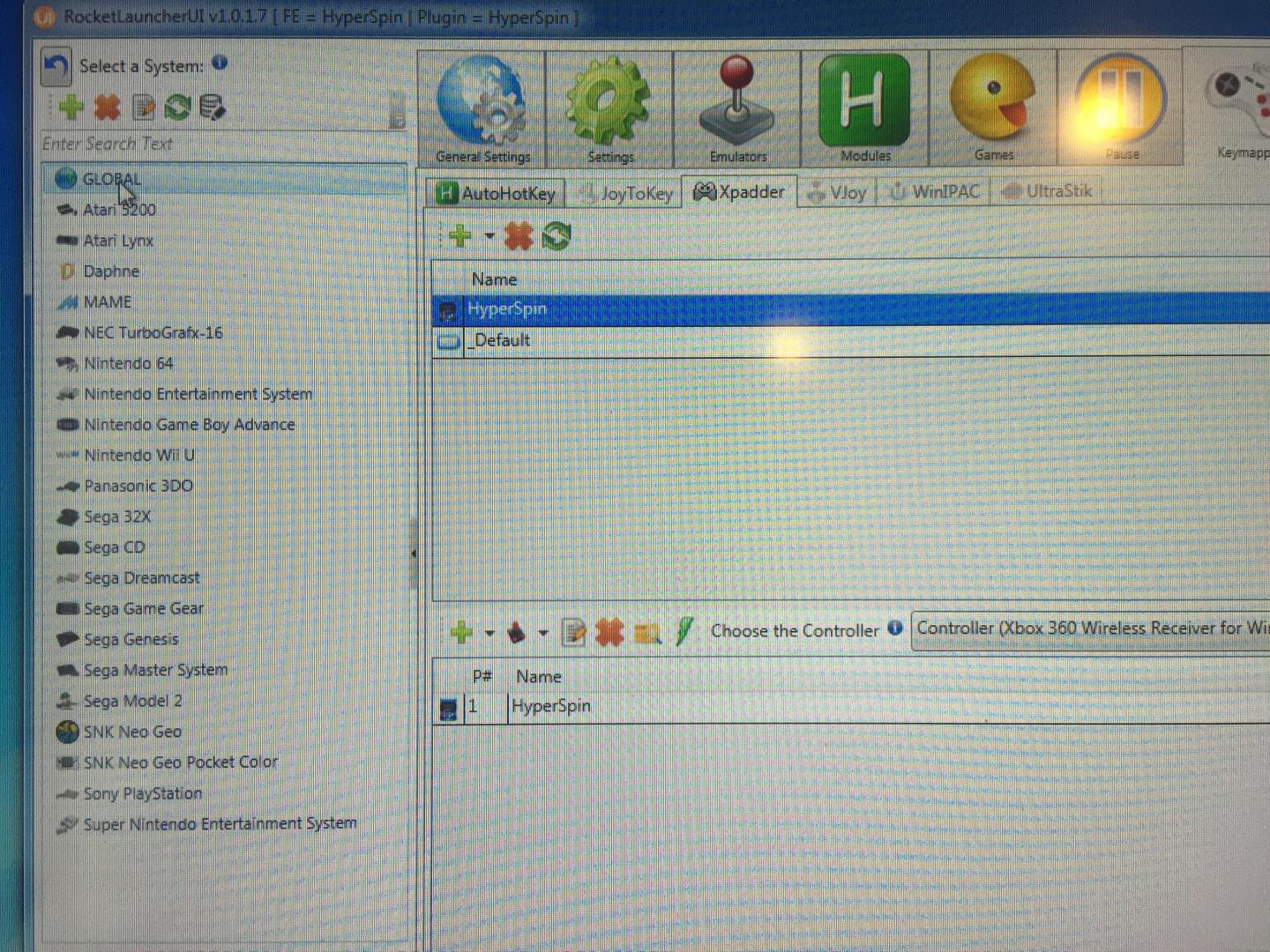

badadd Posted October 8, 2016 Author Posted October 8, 2016 ok, I have managed to xpadder to stay running in the background now, while HS is running, 1 problem down! Next problem - I have setup profiles in xpadder and then setup RL for each of my emulators and global. When I open HS I often have problems getting any systems to run, the up and down arrow work on my controller, but the "A" button which I have mapped to the enter button on my keyboard, doesn't seem to make a system open. Pressing enter on my keyboard still works. I then use my keyboard to select my system, then once this is running, again, the controller doesnt seem to work, as if the profile isnt kicking in. Running the emulators on their own, with xpadder running, with the correct profile chosen, everything works as it should, its just when I use HS that the issues start. I have attached some screenshots of global and one of my emulators / systems:
badadd Posted October 8, 2016 Author Posted October 8, 2016 just when I thought I had fixed the problem... Ok so I think I have pin pointed when this is happening - the controller works (temporarily) in the HS front end, but the minute I start a game it closes xpadder! This is what I think is causing me issues! Any ideas?
