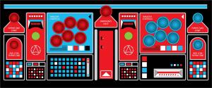

I'm going to cut holes in my cabs control panel soon and I'm looking for some advice on the 2nd player control layout.
I used a 6 button version of the Sega layout found at this link on slag coin (sega) for my Player 1 controls and copied it for player 2.
I've done a mockup of the player 1 controls and have been happy with them.
But I noticed there is a player 2 variant on slag coin that is tilted.
Has anyone here used the Sega layout for their controls, does player 2 need to be tilted. Should they both be tilted?
Anyone care to share their theories or thoughts on control panel layout?
Here's my planned layout at the moment (green circles are joysticks):
Very nice layout first off.
I used the Sega layout and used the lines on the slagcoin template to line it up with marks I had made on the cp.
If the player 2 layout is different, then I wasn't aware and used player one for both.
