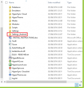

Settings file directory location
For default Windows PC installation ALL your settings files can be found in the Settings folder of your Hyperspin directory (..Hyperspin\Settings)
If you are not using your Hyperspin Android setup on a PC then leave them all in the /Settings folder
If you are combining your PC and Android Hyperspin setups please create the following Settings_Android folder and place a copy of ALL your .ini files inside (..Hyperspin\Settings_Android)
If you are using my Hyperspin Android Base Pack locate your settings files here

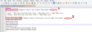

Option 1 & 2
Option 3

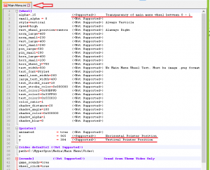

Main Menu.ini
This ini file configures how your Main Menu list will display. There are a few features that can be customised and some that are not supported.
Note:- Your Main Menu systems list will always display vertically to the right.
Video Path, Sounds & Wheel text are not supported
