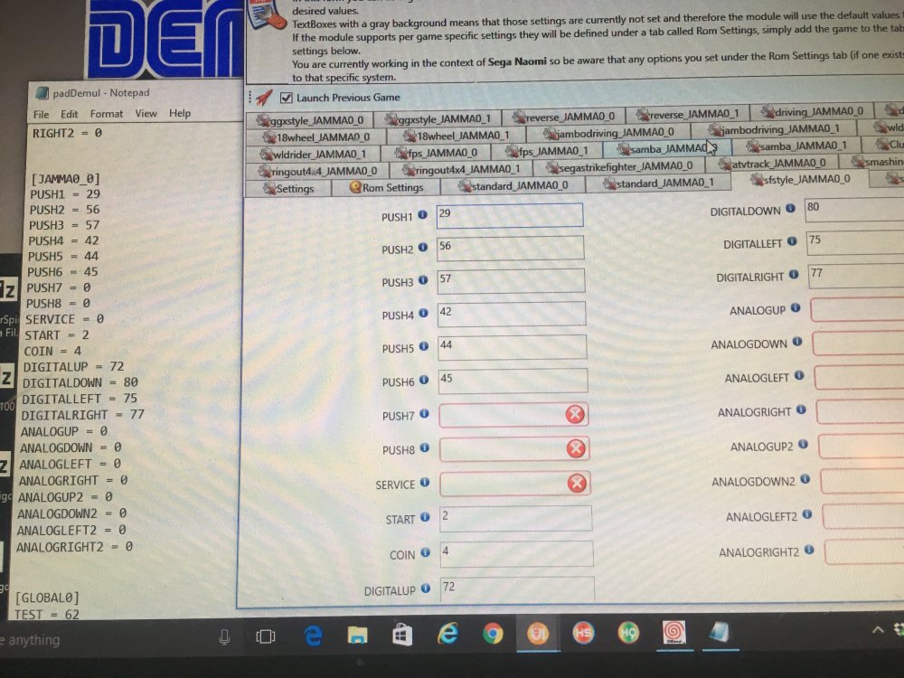

thenoob Posted November 2, 2016 Author Posted November 2, 2016 trhing to do this right but RL/HS isn't recognizing the input data I've put in. attached is a pic , I feel I have done it right. It will work in Demul, I opened up the paddemul.ini inside my demul folder, found the numbers and Input them in the module settings. RL or HS is not taking to the controls. Any idea what's happening, I swear I'm doing this right from my understanding I need to input these controls for each tab in the module (game types) so this one I'm attempting sf2000 which should be the sfstyle? (I imagine that means street fighter style. The whole reason for this is some of the games I want to use the 360, the others is like to use my CP
thenoob Posted November 2, 2016 Author Posted November 2, 2016 Now I am not saving the paddemul.ini after I set up the controls because when I close demul it always resets anyways, this is the whole point of control mapping in the module correct? trying to scratch my head and see what I'm doing wrong.
thenoob Posted November 2, 2016 Author Posted November 2, 2016 I think I just figured it out you don't input those settings in the module in RL you paste them in the actual config 0.5.7 demul in RL/modules i think.
thenoob Posted November 2, 2016 Author Posted November 2, 2016 And that's a negative, didn't work ill wait to see what the community has to say.

thenoob Posted November 3, 2016 Author Posted November 3, 2016 I could do that in the padDemul, but I want to have separate controls in Naomi for different games. You can't do that in the padDemul, it's a "one set" thing. if you open the RL module folder for demul and open 0.7, you can scroll down and see each type of game with separate control functions. I tried to change it there as well but no dice.
