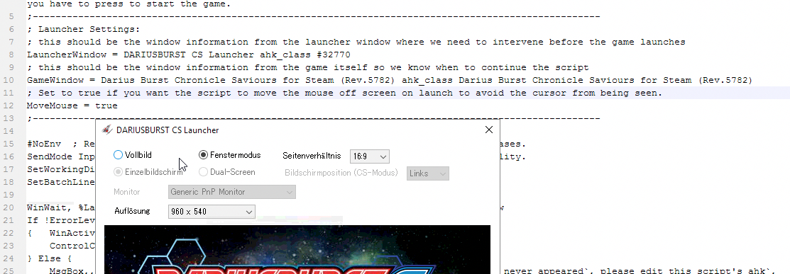

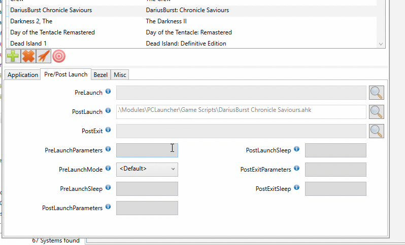

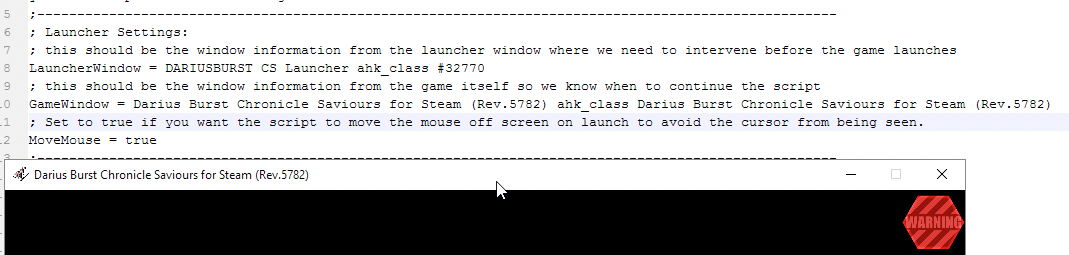

ChrisKant Posted November 9, 2016 Author Posted November 9, 2016 thank you so much, sadly I am not able to make this ahk working :-( first I tried the original one, after that I did try to adjust something. without luck. I put it into my pc launcher / Game Scripts folder and renamed it to the Name of this game within my Rocketlauncher Rom Settings then I made some adjustments like GameWindow Name (here the Launcher Name) but nothing worked. can you give me some advice please.
ChrisKant Posted November 9, 2016 Author Posted November 9, 2016 is it really that complicated? this script as Postlaunch will give me that screen (unknown File)... and there is no information as control name while I am hovering the mouse over the start button :-( Do I need the Autohotkey Application for this?
ChrisKant Posted November 9, 2016 Author Posted November 9, 2016 that was the magic missing thing :-) thank you so much. now it works
