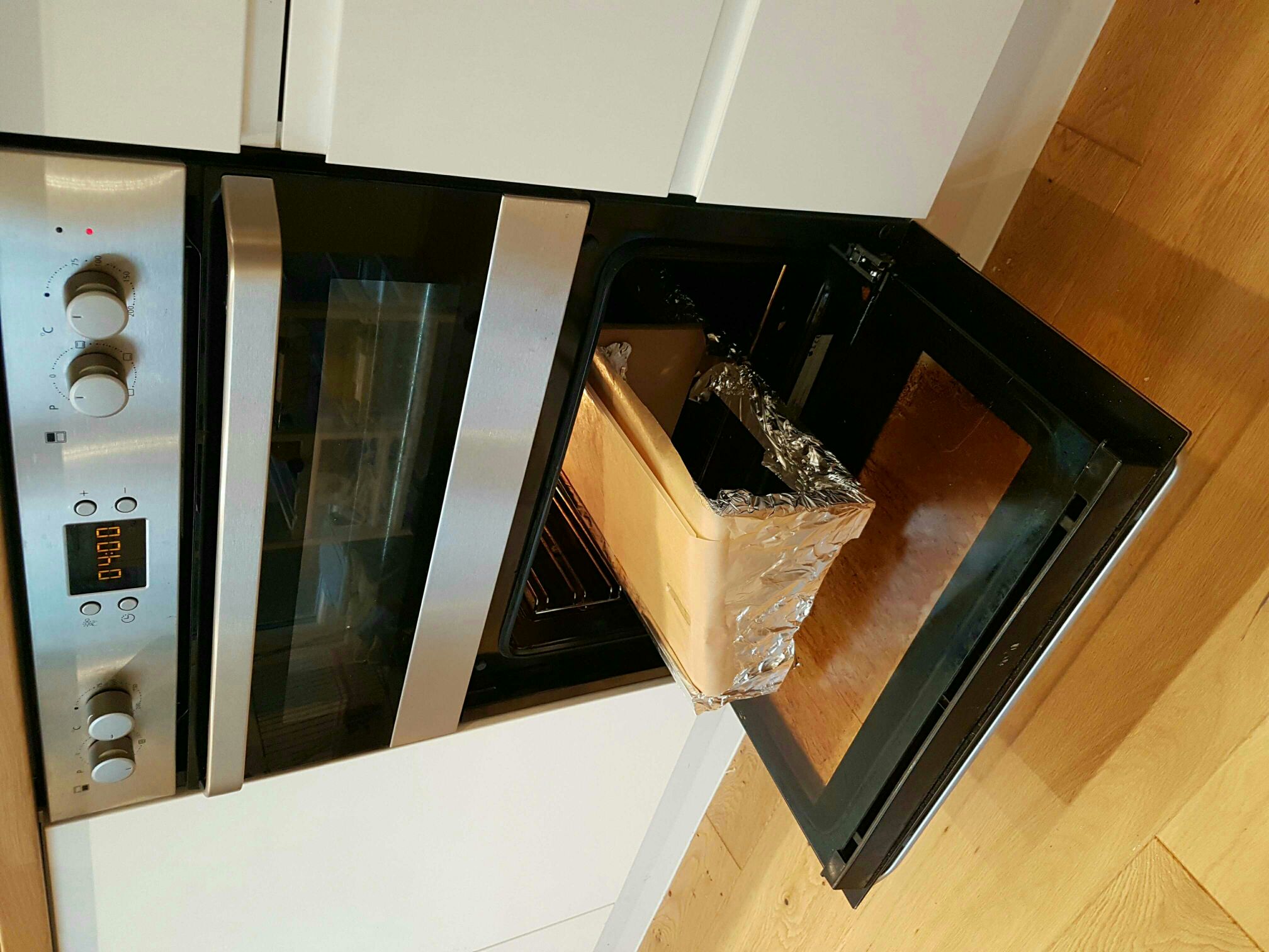

richie_jones Posted January 6, 2017 Posted January 6, 2017 It needs bending slightly so I've build a bending jig and am just about to run a test piece. The Misses gonna go crazy when she sees this in the oven!!!!It's not much of a curve but it's a wide piece 543mm
jq_quint Posted January 6, 2017 Author Posted January 6, 2017 Ha ha ha , yep mine would tear me a new one !Sent from my iPhone using Tapatalk

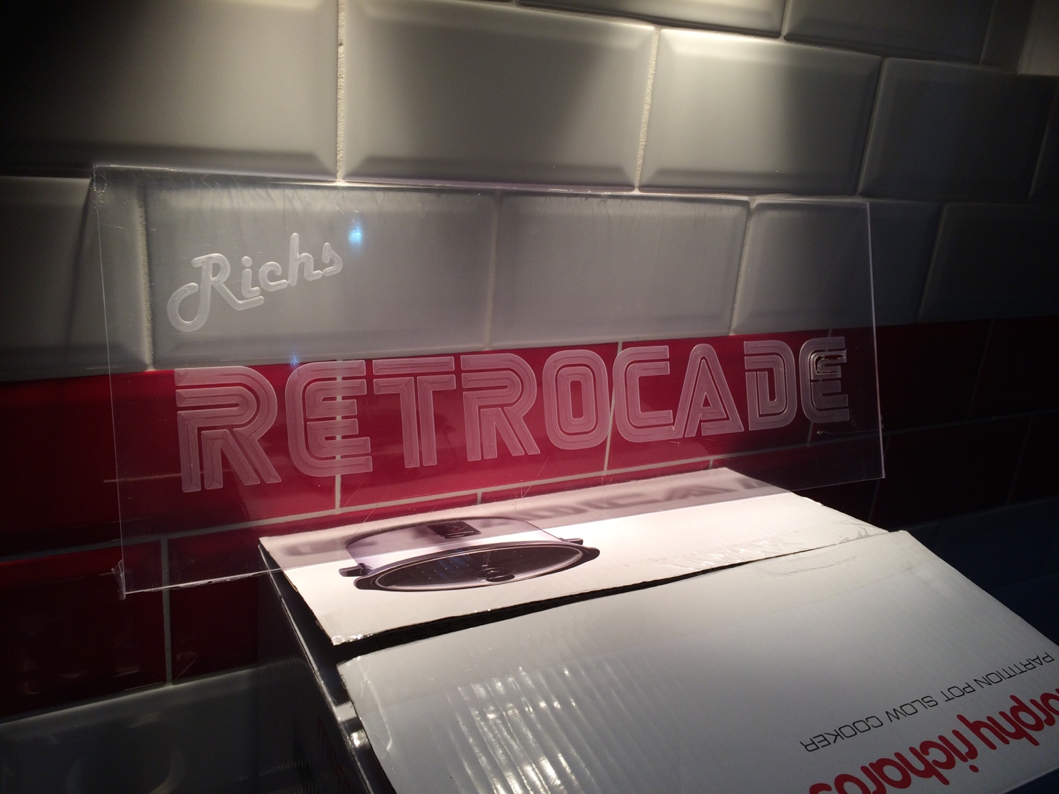

jq_quint Posted January 6, 2017 Author Posted January 6, 2017 Richie - so success well nearly ..... seemed to turn out great , apart from a stupid programming error (when I did the through cut test the other night to test the mirror function forgot to change back to -0.5 doh!)See the top of the E its machines through!!!Anyway I altered and run the rest of the program.I'll use it as a test piece. I have some led lights on their way so I can test it for real....Must admit before I do too many of these I need to make a vacuum table, holding it to do the sides was a pain....Sent from my iPhone using Tapatalk
richie_jones Posted January 6, 2017 Posted January 6, 2017 That looks great...the Mr Robot font takes well to engraving..How far does the engraving go? Do you think it final piece could be done in 3mm?
jq_quint Posted January 6, 2017 Author Posted January 6, 2017 5 minutes ago, richie_jones said: That looks great...the Mr Robot font takes well to engraving.. How far does the engraving go? Do you think it final piece could be done in 3mm? 3mm sheet, yes the engraving is only 0.5mm deep. Why are you thinking it will bend easier?

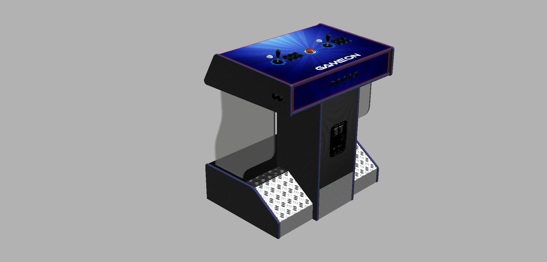

jq_quint Posted January 6, 2017 Author Posted January 6, 2017 Folks, Thought you all would like to see the latest project I'm working with Albatross, just finishing off the final touches, its a replica of the XArcade system. Once i've finished the first off for Albatross may be available as a kit if anyone is interested... Tmold cut where shown, 10mm Acrylic included, Aluminium Not Included.

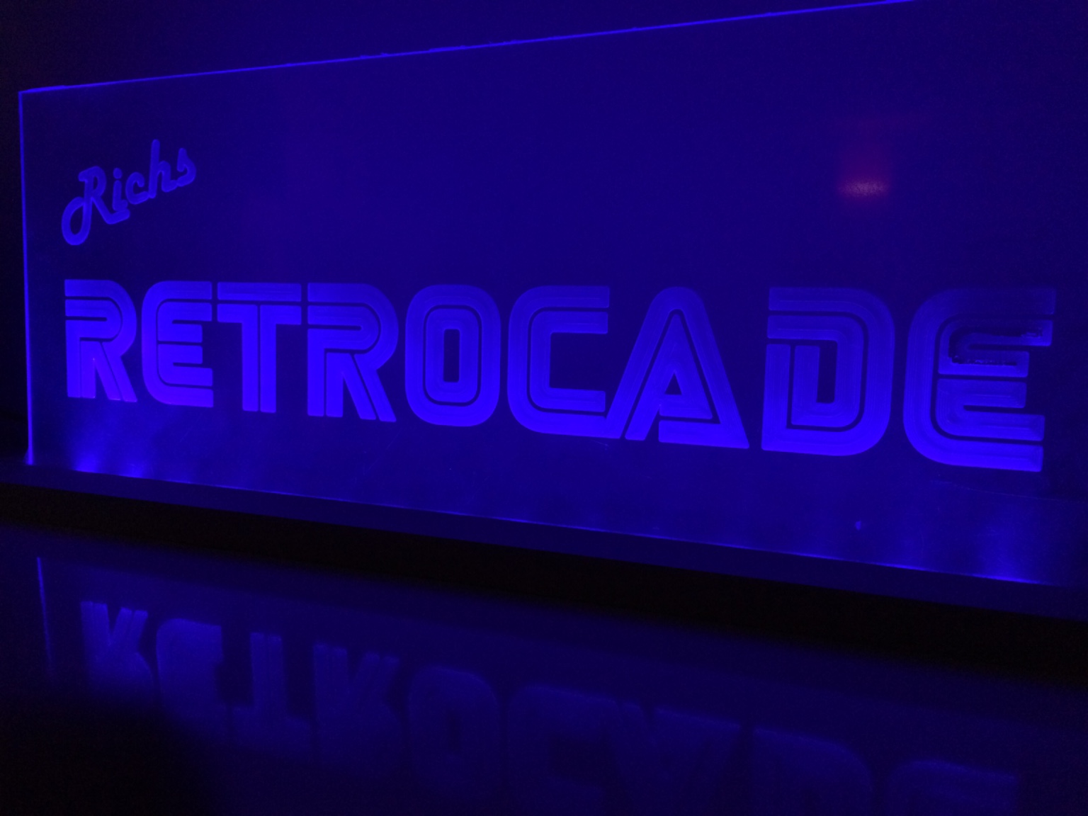

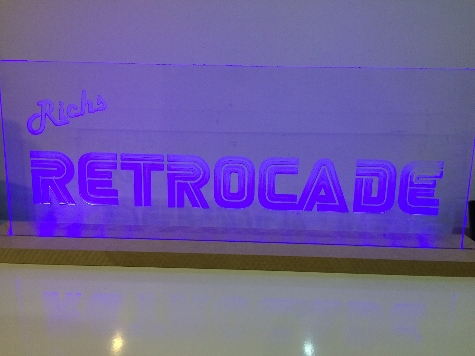

jq_quint Posted January 7, 2017 Author Posted January 7, 2017 Richie - your scrap marquee on the LEDs that arrived today...I am going to the building merchants tomorrow to see if they have 3mm, but can't help thinking bud that this effect gets better with thicker sheet? This is my first attempt with 4mm so I can't confirm that that...Sent from my iPhone using Tapatalk
richie_jones Posted January 7, 2017 Posted January 7, 2017 Yeah it's looks really good. Agree that probably thinner sheet would be less of an effect, but I've backed myself into a corner with my design. I might just get both 4mm and 3mm see what I can do with them..I'm lighting from both edges also
jq_quint Posted January 9, 2017 Author Posted January 9, 2017 Yeah it's looks really good. Agree that probably thinner sheet would be less of an effect, but I've backed myself into a corner with my design. I might just get both 4mm and 3mm see what I can do with them..I'm lighting from both edges alsoGotcha , lighting from both ends will be loads better, gotta get both LED ends sealed around the Perspex end as best you can to reduce the amount of leakage across the sheet surface too bud....Sent from my iPhone using Tapatalk
