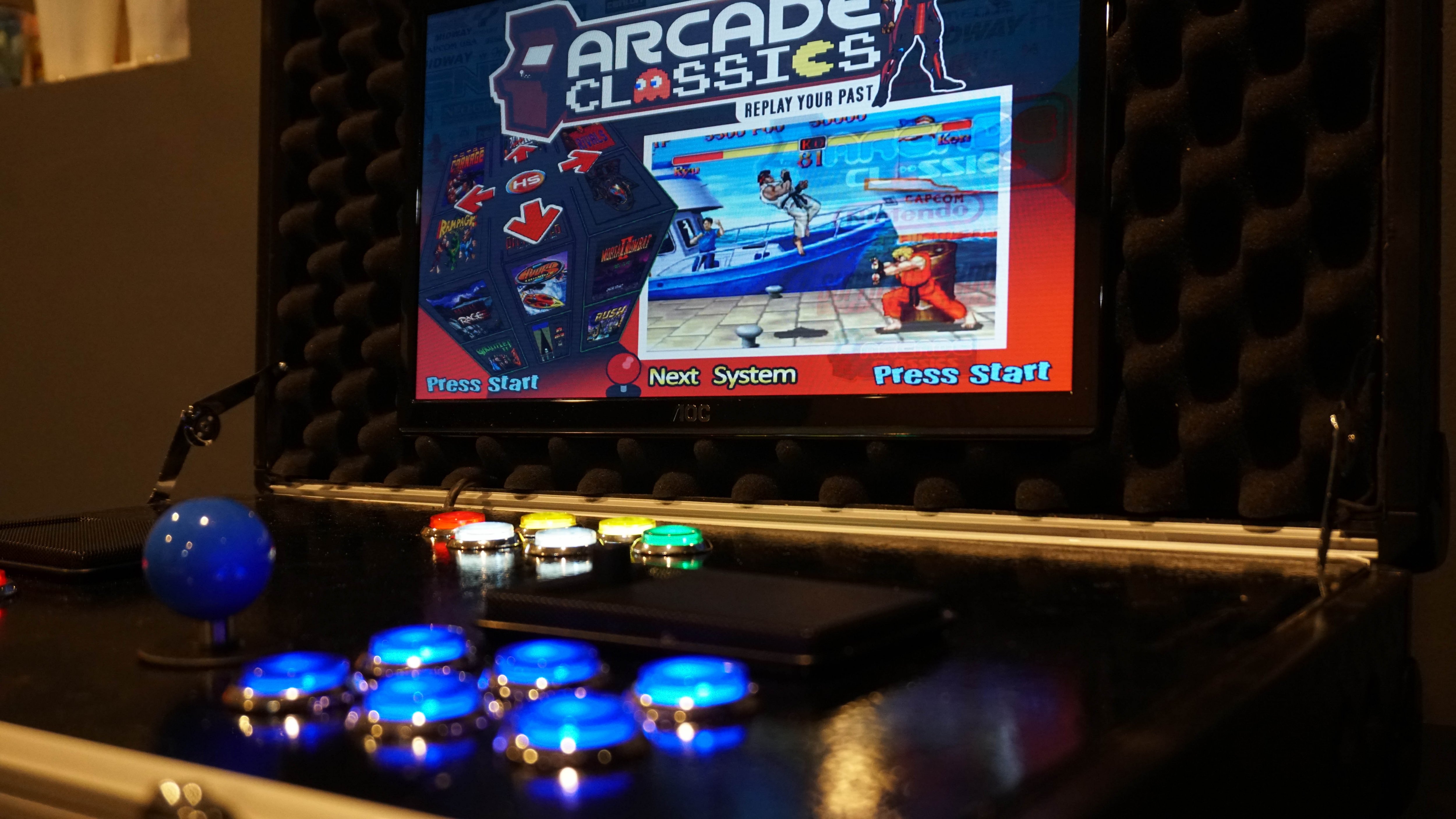

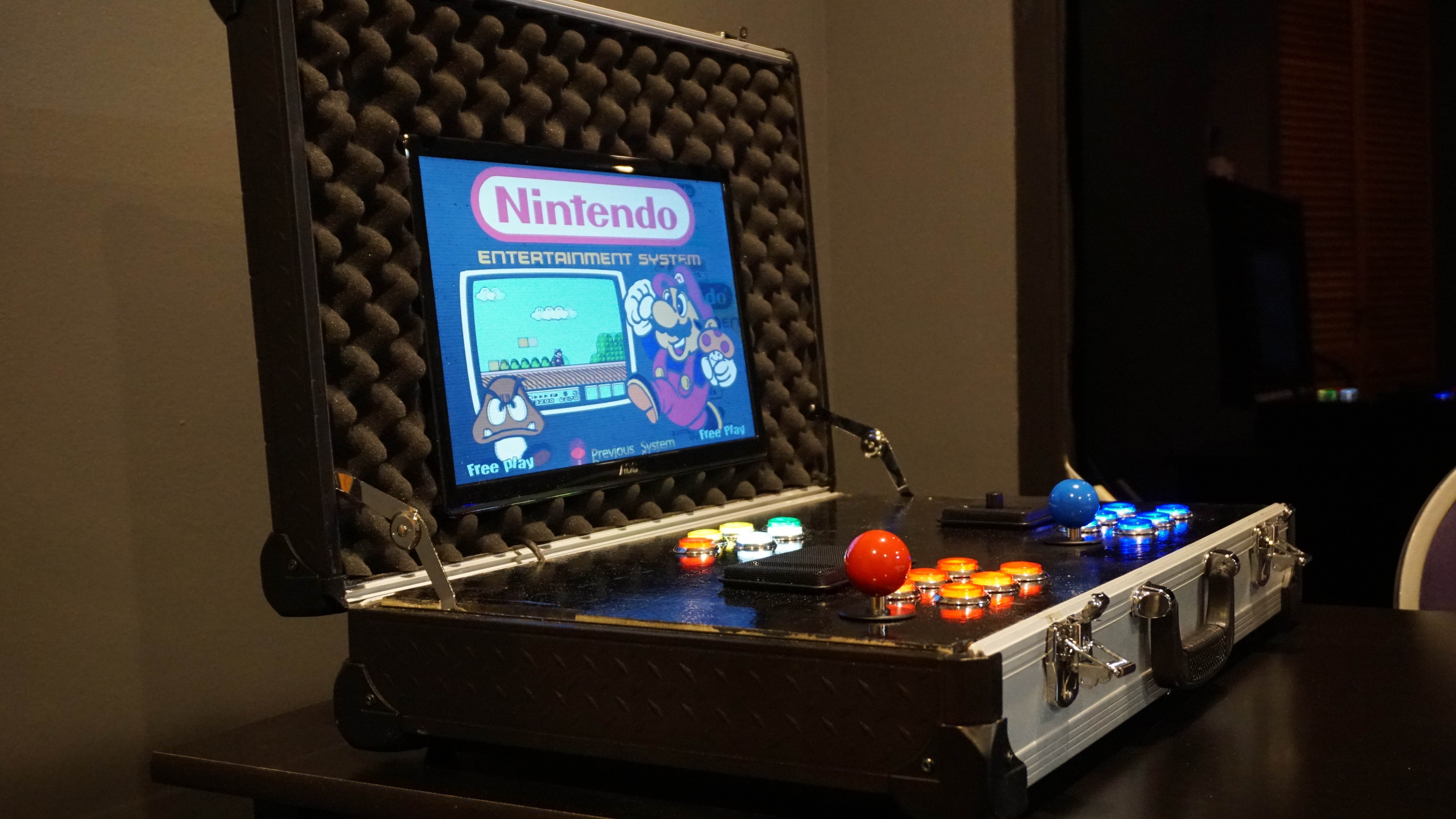

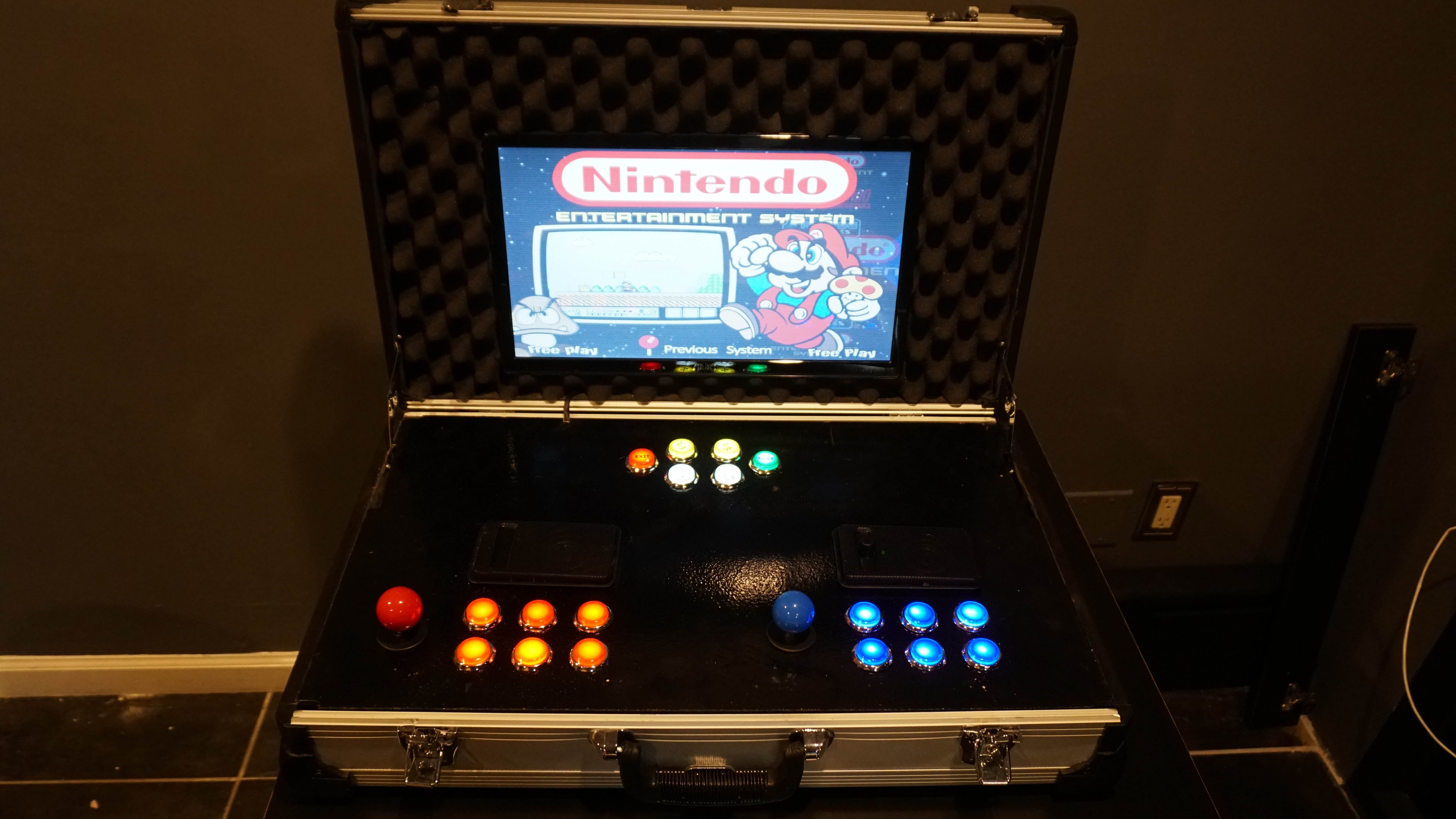

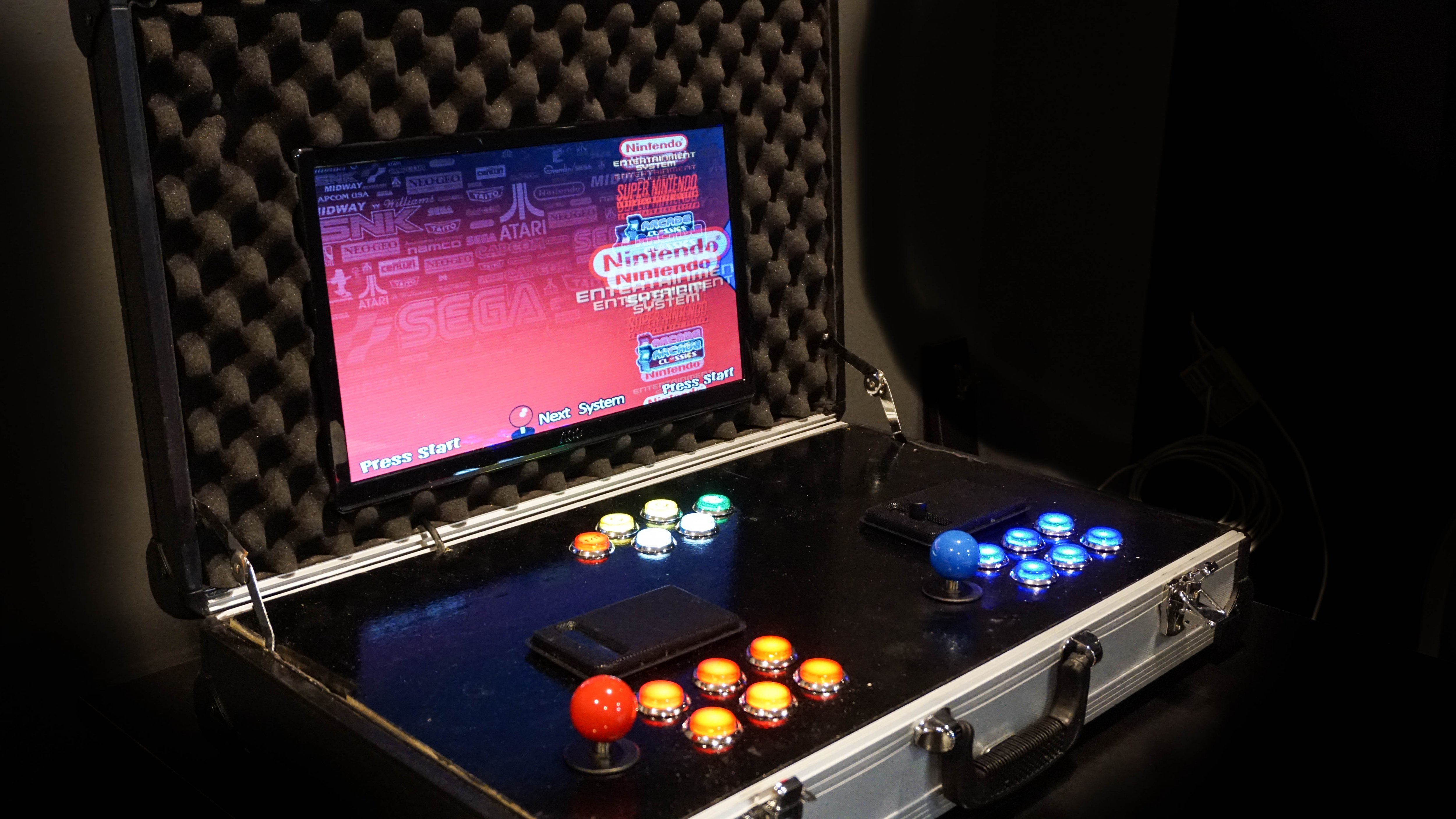

im 90% complete, i just have to mount the pc and the battery pack
the objective was to take arcade on the go. this is in a 26 inch long case, surprisingly it is not that heavy. my only downside is the pc it self. at 200 with 4 gig ram, it cant totally handle some games let alone hyperspin. if i exit a game, it takes 20 secs for the controls to be able to react and function again.
i got a trip to mexico next week and the plan is to take this sucker with me :D
