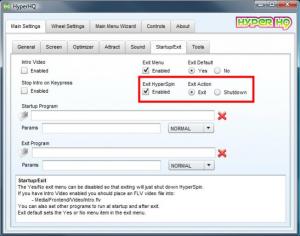

SIMPLYAUSTIN Posted April 12, 2014 Author Posted April 12, 2014 Well I re downloaded all the exe files from the site. Hyper HQ and Hyperspin but still have the same problem. Just so I can check..... can somone please tell me thir setting on the Ext Hyperspin tab on HyperHQ so I can telly them up with mine? Its getting silly now pressing Alt-F4 to quit hyperspin hehehe Simply Austin's YouTube
rfancella Posted April 12, 2014 Posted April 12, 2014 Well I re downloaded all the exe files from the site. Hyper HQ and Hyperspin but still have the same problem.Just so I can check..... can somone please tell me thir setting on the Ext Hyperspin tab on HyperHQ so I can telly them up with mine? Its getting silly now pressing Alt-F4 to quit hyperspin hehehe Austin, Try this. Open up HyperHQ and check these settings: Thanks, Ron Code Monkey and all around Command Line geek!If you like what someone has said or done for you, be sure and 'Thank' them. And if they changed your life, send them a Beer!
SIMPLYAUSTIN Posted April 12, 2014 Author Posted April 12, 2014 OMG!!! Still nothing!!! Thanks though Ron, thats exactly the thing I was looking for to rule that out. Now Im stumped though, not sure what else to try? Simply Austin's YouTube
