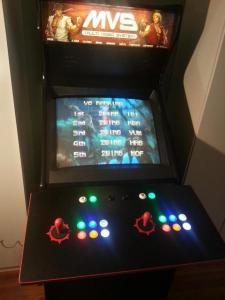

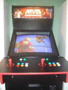

Well, I've finally gotten my cabinet to a point where I can show it off. It started off as a PGA Tour Golf Challenge Edition I purchased for $100 in great condition!
Now it's turned into my custom "MVS". I've always loved the MVS logo and it does an apt job in describing the cabinet so that's what I've called it. NeoGeo purists will hate it I know :P
Front:

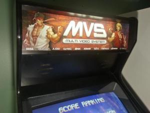

Marquee:
Marquee designed in PhotoShop and printed by GameOnGrafix.com
I must say FANTASTIC print job by those guys, pics do not do it justice

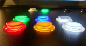

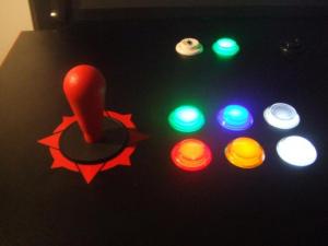

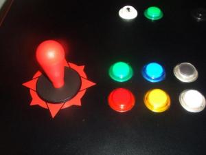

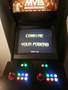

Buttons:
Happ Competition joyticks + Spectralite buttons from GroovyGameGear.com
for the colors I decided to go with a NeoGeo/Xbox controller scheme.
Unfortunately no one makes a black/smoke colored LED button so I am working on either dying or coloring the insert of a clear/white one.

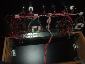

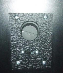

Wiring, Volume & Headphone/Speaker switch:
The volume knob and switch are mounted on a piece of plexi and then covered in vinyl.
Inside pics to come later but here are the specs:
