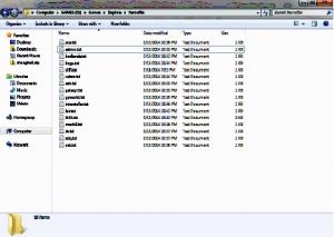

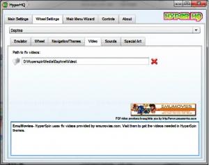

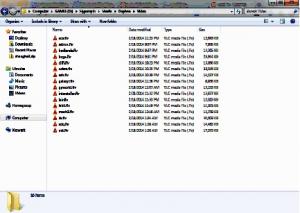

johnsodu Posted April 9, 2014 Author Posted April 9, 2014 I have looked into your suggestions, and unless I am missing something, I think all file names, folder locations and extensions are good to go. I have attached the screenshots you suggested. Also, please follow the YouTube link I made showing the bizarre error (at least to me) in action. The "Any Game" in the clip is a total placeholder theme, and as you see (in speedup, sorry my capture software is not that great) all theme videos don't respond on initial loading of the sub theme. But, once the dummy theme with no video is shown, all of the videos show just fine. Again, any help from this great Hyperspin community would be much appreciated. Youtube shortcut: http://youtu.be/xPz95eVAiuQ
