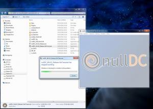

gigapig Posted April 8, 2014 Posted April 8, 2014 I tried looking into this but when I fire up Nulldc it crashed. It was working fine a month ago, its the trouble with running emulation on an open system and not a cab.

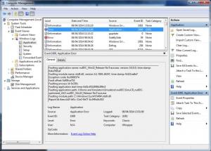

gigapig Posted April 8, 2014 Posted April 8, 2014 Thanks man, but I thinks it's just one of those problems, only an OS reinstall will fix, but I could be wrong. I tried deleting the .cfg file and changing a few settings but no good. Here's what it does. And here is some info from event viewer.
keltoigael Posted April 8, 2014 Posted April 8, 2014 Oh man a ntdll.dll error are not nice. Did you recently have any service pack's or security patches? Do you have all the proper .net framework? *edit* I would firstly backup your nullDC folder and do a fresh install to see if it will get around the error. https://www.youtube.com/channel/UCGAi8dJWR4bpg1oRfItcPCw
keltoigael Posted April 8, 2014 Posted April 8, 2014 I found this it looks like ntdll.dll is the first dll in the string. https://www.youtube.com/channel/UCGAi8dJWR4bpg1oRfItcPCw

gigapig Posted April 10, 2014 Posted April 10, 2014 FYI After reinstalling the OS, nothing had changed. After a bit of a search, I found that it's the PuruPuru plugin causing the problem, So I've removed it from the plugin folder. Nulldc now works, so I just need to figure out the controls as the PuruPuru plugin was the one I was using.
