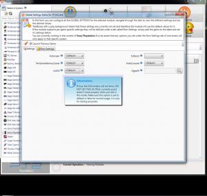

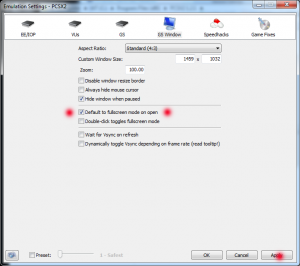

gigapig Posted April 21, 2014 Posted April 21, 2014 Firstly the exit issue is quite clear, but I missed it, it's related to having noGUI set to true in HLHQ. The info clearly states to NOT switch this on. So I set everything to default. The Error "There was an error detecting when PCSX2 finished loading your game. Please report this so the module can be fixed." was sorted by checking the box "Default to Fullscreen on Open" which can be found in PCSX2 Config>Video>Window Settings I'm using bezels and fade in and it's seems fine now.
tzakiel Posted April 21, 2014 Author Posted April 21, 2014 I am able to get it to work again, intermittently (seems to require one start of DT, still investigating) if I enable DT and SCSI and make sure drive it set. So that is my solution for now. noGUI and fullscreen I have had correct from the start... noGUI is set to default in HLHQ, fullscreen on load set to on in PCSX2.
