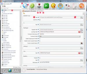

Frogger Posted April 17, 2014 Posted April 17, 2014 Hi Can anyone point me to a good guide for installing Fusion on Hyper spin, I can not get it going My main issue I having is this error: DaemonTools support is enabled but could not find. Please set your DAEMON_Tools_Path to where DTLite.exe is installed or turn off DT support for this system". I have installed Daemon lite and have made sure it is enabled in Global and Sega Master System If anyone has a good step step guide of Fusion/Daemon setup or can help with this error I would really appreciate it
gigapig Posted April 17, 2014 Posted April 17, 2014 Welcome fr_303. You need to set the path to DT Lite in HLHQ.
xHyperSteve Posted April 17, 2014 Posted April 17, 2014 I remember that problem, that should work bro, follow gigapig Be sure to like! Also, subscribe to my YouTube Channel for more videos/HyperSteve https://twitter.com/HyperSteveShow
Frogger Posted April 17, 2014 Author Posted April 17, 2014 Welcome fr_303.You need to set the path to DT Lite in HLHQ. [ATTACH=CONFIG]40242[/ATTACH] Thanks
