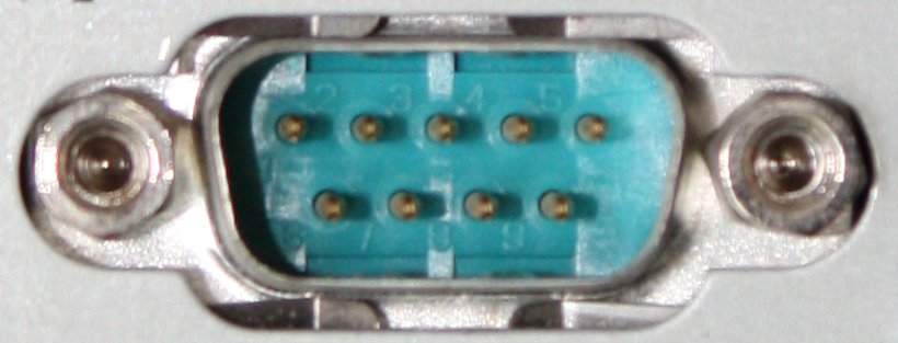

keyboard encoders came in a time when we only had those terrible serial joysticks.
you remember those, the ones with this  connectors

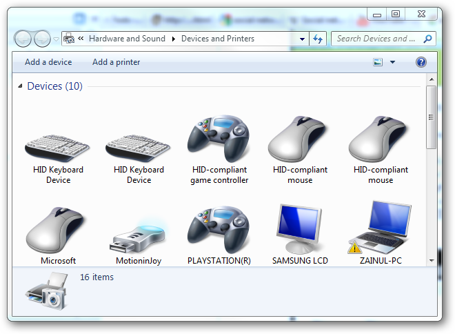

 they are plug and play their is no software. its like pluging in a USB joystick to your PC.
When you plug them in your PC will see them as generic joysticks.
 if you go to your Device and Printers managers you will find a generic joystick.
if you click on Device (the joystick) properties you should see this window
this are images for a PS3 controller but you should see something similar,

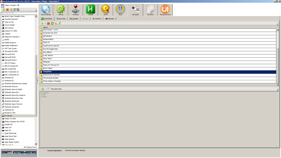

I'm using the Ipac 4(?) ... Just remap the keys for certain games?  I use the AHK (external) setting in RLUI and remap the keys that way.

Hmm no need for second keyboard (but not entirely sure based on what game it is..)
Have PC games Highlighted in RLUI.
First goto Settings and enable AHK method to "External"
Then goto Keymapper (still under PC games) Tab is 'AutoHotKey', click on arrow next to the green plus sign and select the game you want to remap controls.
Goto the green arrow below the game list (about mid page) enter orig. key then the new key you want.
*When it says enter original key you may have to instead press the new key you want and for new key press enter original.
Try the first way and see if that works first...
