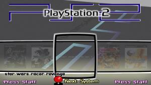

sreisig1 Posted April 23, 2014 Posted April 23, 2014 How do you add a new game to hyperspin? I already have hyperspin setup with the emulators and wheels and games running fine. Now I want to add a game to Hyperspin for PS2 (Star Wars Racers Revenge). I have the iso file and loaded it with psx2 and it works fine. Now for hyperspin: So far I went to H:\Hyperspin\Databases\Sony Playstation 2 and added the line <game name="star wars racer revenge"> <description>star wars racer revenge</description> <cloneof></cloneof> <crc></crc> <manufacturer></manufacturer> <year></year> <genre></genre> </game> When I load hyperspin I can see the text of star wars racers revenge in the PS2 wheel. How do I go about have it have a theme instead and more importantly have it point to the iso file so it works in hyperspin. New to this and never added a new game before. Friend gave me his old setup. This is what I have so far, just the text in the wheel, where do I go from here?
