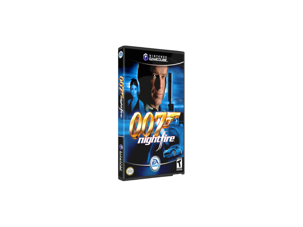

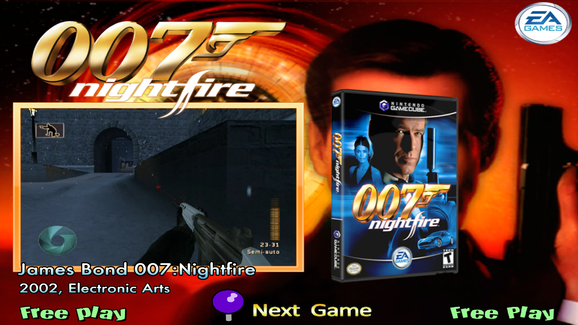

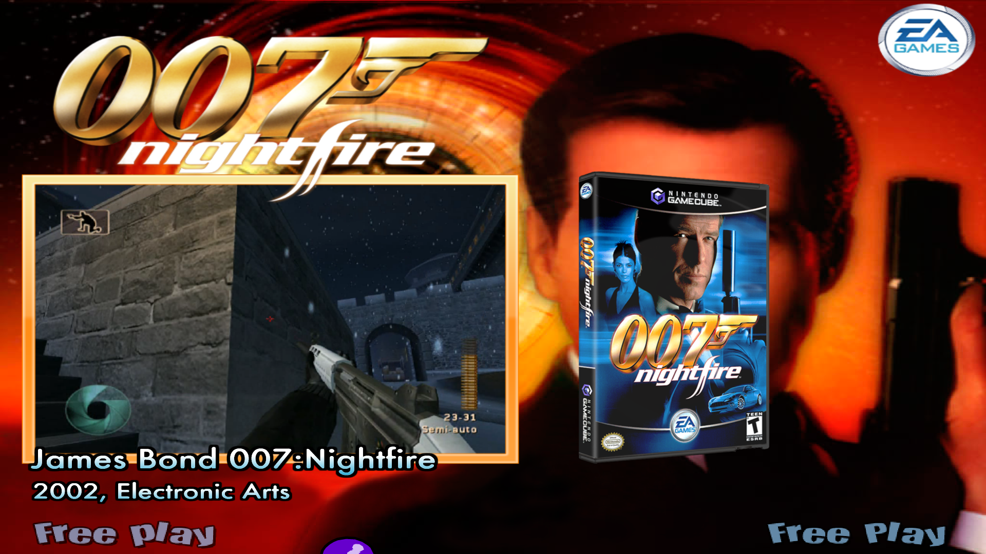

doohan Posted December 9, 2017 Author Posted December 9, 2017 On 12/6/2017 at 12:30 PM, Bungles said: Expand Hello, This the kind of theme that I'd like todo in16:9. This is the original PSD file linked. Qulaity is much better. 007 - Nightfire (France).psd007 - Nightfire (France).psdFetching info... This is the png that I got resized from the PSD for the Artwork 3 (3D box) 007 - Nightfire (France).psd007 - I see that there are more and more swf files for artworks. I've heard that quality is better than a png file. What is a simple way with Adobe Illustrator to convert png artwroks in swf artowrks to save quality of those artworks? Thanks and regards,
Bungles Posted December 10, 2017 Posted December 10, 2017 Yeah the issue it seems is that its expanding the Box Art to match the 16:9 resolution when viewed in Hyperspin. You need to convert to the right ratio so they expand correctly when viewed at 16:9 resolutions. I.E X-Axis=53% Y-Axis=71% Retro Cafe - Universal ThemeHyperControl - Main Menu Config and Apps WheelAudiocade - Main Menu Music PlayerTelltale Games WheelPCGamers Top 100 PC Games 2014 WheelMGS HD Exit Screen8-Bitdo Special ArtAll Contributions My Youtube Channel - https://www.youtube.com/user/3ungle
doohan Posted December 10, 2017 Author Posted December 10, 2017 Hello Bungles, Thanks for the answer. I tested something very interesting...No resizing of the picture (except 16:9) and quality stay good. I think I have to find another way to reduce the size of the 3D boxes artworks than Photoshop to keep quality...
doohan Posted December 11, 2017 Author Posted December 11, 2017 Hi Bungles, Fizen gave me a flash script that upscaled quality in 1080p and resize in 16:9 in one and it works like a charm. swf has definitly better quality than png... Now, I will do all the themes I've dreamed of... Best regards,
