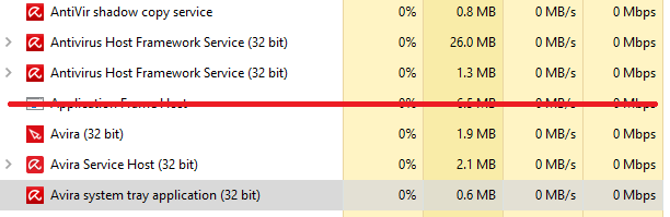

Bungles Posted January 15, 2018 Posted January 15, 2018 I do get some notifications as you do with most freeware scanners, but its not very intrusive and it wont display on-top of Hyperspin, so you wont really notice it. That being said if your cabinet is not going to be browsing the web or downloading directly from "Naughty" sites.. you may not need a 3rd party antivirus/firewall. (Windows Defender is actually quite competent these days..) But coming from AVG it uses a fraction of the resources. CPU MEM DISK NET Retro Cafe - Universal ThemeHyperControl - Main Menu Config and Apps WheelAudiocade - Main Menu Music PlayerTelltale Games WheelPCGamers Top 100 PC Games 2014 WheelMGS HD Exit Screen8-Bitdo Special ArtAll Contributions My Youtube Channel - https://www.youtube.com/user/3ungle
