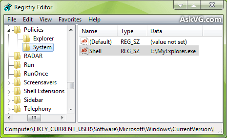

STEP 3.a. If you want to set the customized shell to currently logged in user only which is also recommended, go to following key:
HKEY_CURRENT_USER\Software\Microsoft\Windows\CurrentVersion\Policies
3.b. Under "Policies" key look for another key named "System". If its not present, create it manually.
3.c. Now select "System" key and in right-side pane, create a new String value Shell and set its value to the full path of your desired program. For example, if you modified Explorer.exe file and saved it somewhere else such as E:\MyExplorer.exe, then set value to E:\MyExplorer.exe.
Note: If you want to set a 3rd party program as default shell like Hyperspin, set the value to the full path of that program's EXE file.
3.d. That's it. Once you finish the steps, restart your system and you'll see your desired program once you log into Windows.

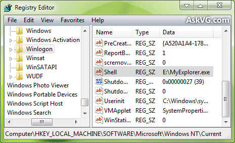

STEP 4.a. If you want to set customized shell for whole system including all user accounts, go to following key:
HKEY_LOCAL_MACHINE\SOFTWARE\Microsoft\Windows NT\CurrentVersion\Winlogon
4.b. In right-side pane, look for String value Shell. Its value would be set to explorer.exe. Double-click on it and change its value to your customized Explorer.exe path or to desired 3rd party shell program's full path as mentioned in step 4.c.
4.c. Restart your system and get ready to boot into your desired shell program.
NOTE: If you face problems after changing the shell or you want to restore default user interface, don't worry. Press Ctrl+Shft+Esc keys together to launch Task Manager. Click on File -> New Task option and type regedit and press Enter. It'll open Registry Editor. Now you can safely remove Shell string value created in step 3.b to restore default Explorer.exe file as Windows shell. Or if you modified value of Shell string using step 4.b, restore its value to explorer.exe and restart your system.

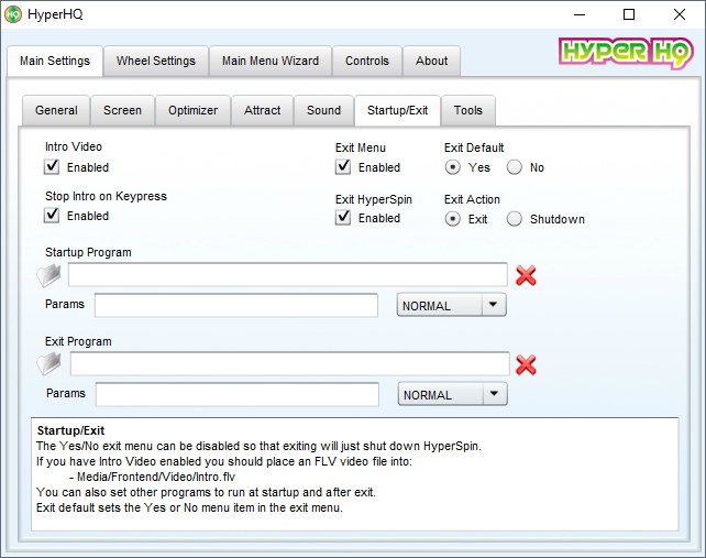

You can also load HyperHQ and set Hyperspin to load your JoyTray as part of its startup routine.
Simply add the JoyTray .exe in to the Startup Program (Select the folder to the left and select your .exe file), add any additional parameters if it needs them and set the preferred state be it normal, minimized, Hidden etc.
