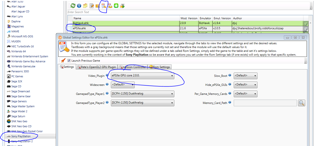

Spawk Posted April 4, 2018 Posted April 4, 2018 Full disclosure: I am not a big PS1 fan and I use PSXFin for my setup. It only runs D3D (I am pretty sure OpenGL is preferred in most cases). All my HS uses individual emulators. I did start a RetroFE setup with RetroArch but... I dunno, I just don't like RetroArch! lol If it won't play directly in RA, then it surely wont work in RL/HS either. You said directly in epsxe works so that would be a good place to start. By default, RL uses petes opengl plugin so if you want to use D3D then edit the module settings here:
krikon Posted April 4, 2018 Author Posted April 4, 2018 It works, i totally overlooked setting up the stuff in your screenshot, im so relieved. Thank you, u really saved me, i would not have figured this out. Im very thankful.To anyone who read this thread, let it be a lesson. Have more patience than me, don't come across as an jerk (as i probably did even though that was not my intention). Now i can configure the other systems i could not get to work. Shame i had to waste a whole day on getting this far lol
