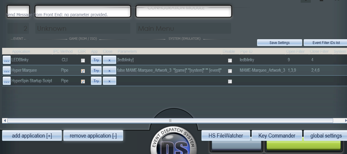

MydknyteStyrm Posted May 12, 2018 Posted May 12, 2018 Ok, I have the exact setup. Stop using Joy2Key. I use Hyperspin Startup Script. It stopped the random wheel jump one game at a time when I selected a game. Make sure on HyperHQ there are no Joysticks selected to operate it. Its never been fixed and probably never will be. I have EDS load up everything. LedBlinky, Hypermarquee and Hyperspin Startup Script. Add HSS to your EDS setup. My code looks like this for HSS in regards to the joysticks. I use four Ultimarc360s, and all four can control the Hyperspin Wheel. Until the devs actually make a working Hyperspin, this was the best solution I found. I tried xpadder and joy2Key, and find that they work sometimes, but cause glitches in HS, like what youre experiencing. The only catch using StartupScript, is that the joysticks will stop responding if nobody touches the arcade for at least 20 minutes. If you just let HS sit on attract, it will just decide to stop reading the joysticks. I think its a memory leak that has never been fixed. Hope this helps! [Required] HyperSpin_Folder_Path=C:\Hyperspin\ [General] Primary_Color_RRGGBB=363636 Secondary_Color_RRGGBB=ffffff [Controls] Joysticks_Enabled=True Joysticks_MaxNumberOfJoysticks=4 Joystick_Delay=50 Joystick_Deadzone=50 Joystick_Up=JoyY- Joystick_Down=JoyY+ Joystick_SkipUp=JoyX- Joystick_SkipDown=JoyX+ Joystick_SkipUpNumber= Joystick_SkipDownNumber= Joystick_HyperSpin= Joystick_Genre= Joystick_Favorites= Joystick_Start= Joystick_Exit= Joystick_Roulette= Joystick_Volume= Joystick_Volume_Close= Joystick_QuickLaunch= Joystick_QuickLaunch_Close= Joystick_Info= Joystick_Info_Close= Joystick_Filters= Joystick_Filters_Close= [Startup] Minimize_Background_Windows_Enabled=true Window_Classes_To_Not_Minimize=Shell_TrayWnd,Button Process_Name_To_Close_1= Program_To_Run_Target_1= Program_To_Run_Working_Dir_1= Program_To_Run_MaxMinHide_1= [Exit] Restore_Windows_On_Exit=True Process_Name_To_Close_1= Program_To_Run_Target_1= Program_To_Run_Working_Dir_1= Program_To_Run_MaxMinHide_1= [Roulette] Roulette_Key= Roulette_Min_MilliSeconds=3000 Roulette_Max_MilliSeconds=8000 [Volume_Menu] Volume_Menu_Key= Volume_Bar_Offset_From_Bottom=44 [QuickLaunch] QuickLaunch_Key= QuickLaunch_Enabled=false QuickLaunch_Left_Offset=5 QuickLaunch_Top_Offset=10 QuickLaunch_Bottom_Offset=10 Item_1_Path= Item_1_Parameters= Item_1_LogoPath= Item_1_Ignore_Process_Close=false

MydknyteStyrm Posted May 16, 2018 Posted May 16, 2018 Thank you. What does your EDS settings look like for HS Startup Script? In my HyperEDS I have Hyperspin Startup Script set to CLI, and [event] parameters, and nothing else. Sent from my iPhone using Tapatalk Pro

vincefaro Posted May 21, 2018 Author Posted May 21, 2018 I was just wondering why you have CLI for Led Blinky and Pipe for Hypermarquee , I have CLI for both LEDBlinky and HM. I was just thinking if that was my problem. Also, I installed HS startup script . My buttons on my joystick are not working now. How do I adjust in the HS Script?
vincefaro Posted May 24, 2018 Author Posted May 24, 2018 On 5/12/2018 at 7:26 AM, MydknyteStyrm said: Ok, I have the exact setup. Stop using Joy2Key. I use Hyperspin Startup Script. It stopped the random wheel jump one game at a time when I selected a game. Make sure on HyperHQ there are no Joysticks selected to operate it. Its never been fixed and probably never will be. I have EDS load up everything. LedBlinky, Hypermarquee and Hyperspin Startup Script. Add HSS to your EDS setup. My code looks like this for HSS in regards to the joysticks. I use four Ultimarc360s, and all four can control the Hyperspin Wheel. Until the devs actually make a working Hyperspin, this was the best solution I found. I tried xpadder and joy2Key, and find that they work sometimes, but cause glitches in HS, like what youre experiencing. The only catch using StartupScript, is that the joysticks will stop responding if nobody touches the arcade for at least 20 minutes. If you just let HS sit on attract, it will just decide to stop reading the joysticks. I think its a memory leak that has never been fixed. Hope this helps! [Required] HyperSpin_Folder_Path=C:\Hyperspin\ [General] Primary_Color_RRGGBB=363636 Secondary_Color_RRGGBB=ffffff [Controls] Joysticks_Enabled=True Joysticks_MaxNumberOfJoysticks=4 Joystick_Delay=50 Joystick_Deadzone=50 Joystick_Up=JoyY- Joystick_Down=JoyY+ Joystick_SkipUp=JoyX- Joystick_SkipDown=JoyX+ Joystick_SkipUpNumber= Joystick_SkipDownNumber= Joystick_HyperSpin= Joystick_Genre= Joystick_Favorites= Joystick_Start= Joystick_Exit= Joystick_Roulette= Joystick_Volume= Joystick_Volume_Close= Joystick_QuickLaunch= Joystick_QuickLaunch_Close= Joystick_Info= Joystick_Info_Close= Joystick_Filters= Joystick_Filters_Close= [Startup] Minimize_Background_Windows_Enabled=true Window_Classes_To_Not_Minimize=Shell_TrayWnd,Button Process_Name_To_Close_1= Program_To_Run_Target_1= Program_To_Run_Working_Dir_1= Program_To_Run_MaxMinHide_1= [Exit] Restore_Windows_On_Exit=True Process_Name_To_Close_1= Program_To_Run_Target_1= Program_To_Run_Working_Dir_1= Program_To_Run_MaxMinHide_1= [Roulette] Roulette_Key= Roulette_Min_MilliSeconds=3000 Roulette_Max_MilliSeconds=8000 [Volume_Menu] Volume_Menu_Key= Volume_Bar_Offset_From_Bottom=44 [QuickLaunch] QuickLaunch_Key= QuickLaunch_Enabled=false QuickLaunch_Left_Offset=5 QuickLaunch_Top_Offset=10 QuickLaunch_Bottom_Offset=10 Item_1_Path= Item_1_Parameters= Item_1_LogoPath= Item_1_Ignore_Process_Close=false I can;t get my buttons to work on my Joystick. How do I set this up?

MydknyteStyrm Posted May 27, 2018 Posted May 27, 2018 My HyperHQ ledBlinky path goes to the renamed LedBlinky in my EDS folder. In regards to your buttons not working using Hyperspin startup script, are your buttons part of your joystick or are they on a keyboard encoder like an IPAC?Sent from my iPhone using Tapatalk Pro

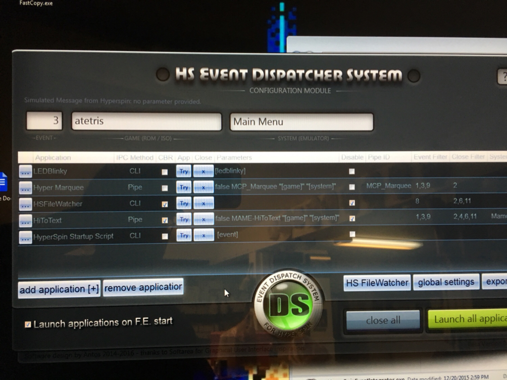

vincefaro Posted September 24, 2018 Author Posted September 24, 2018 OK , I now have the buttons working and the joysticks using the startup script. I still have issues when I use EDS, and my three programs LED Blinky, HS Startup Script , and HM. Either, when I am moving up and down on the wheel the game will still skip up one game or skip up a full section. This is frustrating . Here is my EDS setup . And here is my mame.ini i use Groovymame .201 now . And I have two monitors which the Marquee still shuts off when I select a game so the marquee goes away . The marquees show only in HS . Any help would be aprreciated. Thanks mame.txt
