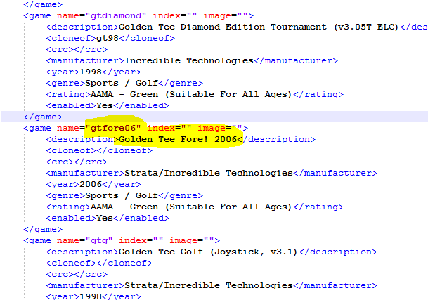

No renaming of anything is needed. Simply add it to the xml:
Description can be anything you like. Then set "Skip Checks" to "Rom Only" under Mame/Settings/MainSettings in RLUI.
Oh and yes you need a dummy "gtfore06.zip" in your rom folder, it can be empty as it is only used to populate the wheel in through HQ.
